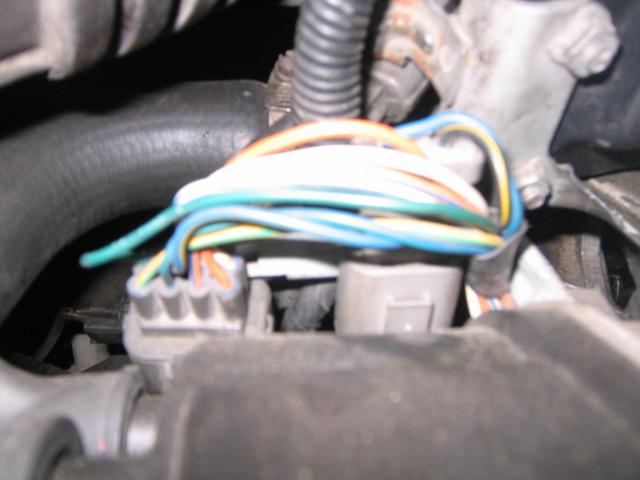

For the few secs needed to inspect for water, the spark plug leads could remain unconnected. Alternatively, pull the electrical connector to distributor, so no spark is generated.
There appears to be two electrical connectors with wires going to the distributor. Which should I pull? Both? The one on the right in this picture has only two wires going into the distributor (one of which is black with yellow stripe), whereas the one one on the left has up to eight or so.

Old Oct 18, 2014 | 01:19 PM
  #26
Posts: 16,337
Unplugging both will not hurt anything. The plug with the blk/yel wire likely only needs pulled, but I would unplug both.

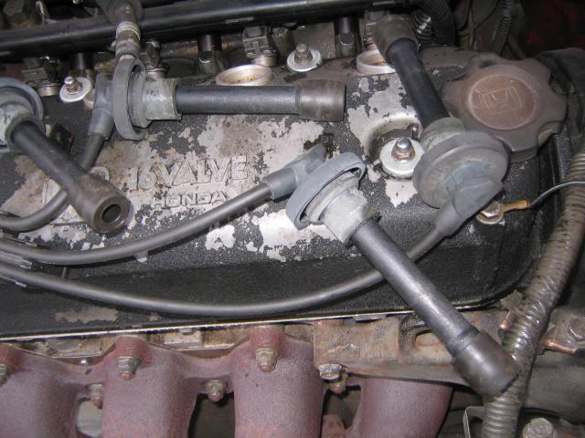

I figure at the very least at this point I might go ahead and try turning cranking the engine with three of the four plugs removed to see if I see any water squirt up out of any of those holes. I've got the spark plug wire connections lying around on top of the engine like shown in the photo below. Will that be a fine situation for the brief time I want to do the cranking and observing for water squirt?

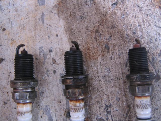

Also I took a pic of the three removed plugs:
Any comment/advice about the plug removal issue I mentioned, and whether a brief engine crank with those plug wires lying there like that should be fine, and maybe in regard to the appearance/condition of those three plugs would be appreciated. Oh and I almost forgot, any comment in regard to the coolant sytem pressure loss as I described. Seems that at least a quart or more of coolant has been "disappearing" every few weeks, with quite minimal daily short distance driving of the vehicle.

Plug removal issue is likely carbon on the plug threads causing binding. You might try a good soak of PB Blaster and allow several hrs to soak through. Warming engine for 2-3 mins before attempting to remove plug may help also. Work slowly, loosen/tighten on plug to hopefully push debris out of the way. See following video:
If you reuse old spark plugs, clean threads w/ wire brush and use small amount of anti-sieze on threads.
Coolant system test was not a positive leak detection IMO. Loss of 1 lb is easily possible w/ small temp changes of coolant unless it was dead cold. This test may indicate head gasket is not the problem (good news!).
Agree you should test other 3 cylinders while plugs are out.
