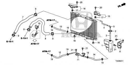

Old Oct 17, 2012 | 09:26 PM
I just looked at the 2008 pictures, the ATF hoses are the small ones in the lower tank of the radiator. #13 & 14
Attached Thumbnails New here at HAF, also in need of some directions-2008-v6-radhoses.jpg

Jim, thanks so much for the diagram. Looking at that I feel more confident that I can do it. The leaking is not bad at all probably just a tiny hole and only leak at high pressure. I commute 1.5 mile to work so I can drive it for now until my replacement arrive. I'll post an update after I have it replaced.
Old Oct 18, 2012 | 09:03 AM
Disconnect hoses (taking care of fluids) & disconnect fan wires.
Unbolt the upper brackets which are like rubber grommets holding the pins that are part of the radiator.
Lower pins on the radiator should simply lift out from their respective sockets.
Sounds easy, right? Trouble is the small space you have to work in. That drawing doesn't show the fans with their shrouds. Remove those after the radiator is out. I haven't done this on a V-6 so can't offer firsthand help.
