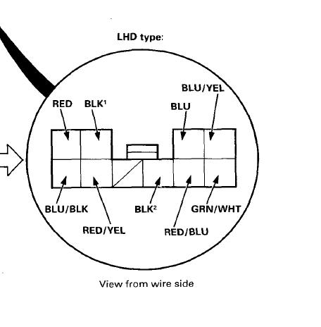

Is the clock keeping time?
Are the brake lights working?
Also, got my gens confused, the clock doesn't come out that easy......but the window switch does .
Pull the window switch and turn the key to on. The BLU/BLK and GRN/WHT should have 12v to ground. Do they?

Clock does keep time, but only displays when depressed.
The window switch is obviously inside the door panel and doesn't seem easy to get to other than pulling??
The brake lights do come on.
