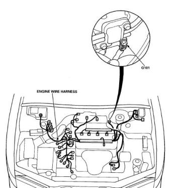

No codes and won't get above ~2800 rpm. In you other thread I know you said that you checked the MAP and TPS connections but PLEASE check again and post the colors of the three wires going to the MAP sensor.
Next, there is a very important ground on the drivers end of the plenum (G101). Verify that it is connected, clean and tight.

Ok. Wires to the MAP are Yellow, green/white stripe, and a white. I re-cleaned the ground on the driver side of the plenum. Also, I removed and cleaned the IAC and Throttle Body. Coolant topped off, thermostat opening. No vacuum leaks. Still can only get 2800 rpms out of it. Ugh!
