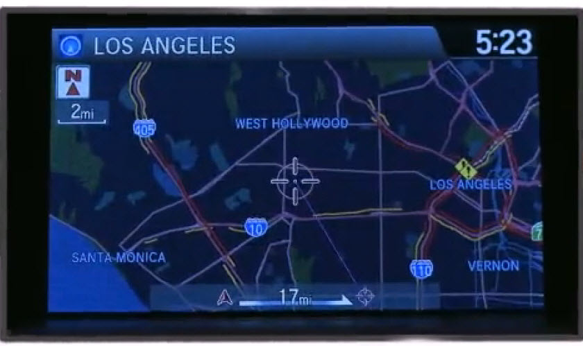

Old Nov 19, 2013 | 10:48 AM
The compass should be displayed on the navigation screen in the upper left hand corner.
On the Intelligent Multi-Information Display (i-MID)for the Touring model, it only displays when in the navigation screen.
Intelligent Multi-Information Display (i-MID) | 2013 Honda Accord-Sedan | Honda Owners Site

Old Nov 19, 2013 | 01:14 PM
pspens's Avatar
Joined: Oct 2013
Posts: 87
From: Indianapolis, IN
Yeah I see what is shown in the attached jpeg. Note that isn't a compass reading. That's an indication that you're in North-Up mode. There are 2 modes, North Up and Direction Up. I haven't tried the direction up mode to see what it looks like. Anyway, the chart of features is obviously erroneous.
