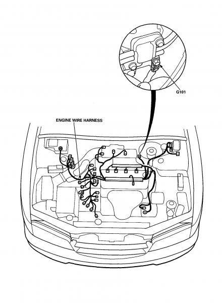

There is an important ground on the driver's side of the upper intake manifold. Disconnect and clean like the battery cable. I attached a picture below.

Here is that pic.

Checked the battery terminals & cables, they're clean. Cleaned both sides of the ground wire & the plenum. Inspected all the cables shown on the diagram under the hood, all as they should be. Checked the mount vacuum line, its plugged in. Found one hose clamp which wasn't in place, installed it and test drive (after an ECU reset); no change.
