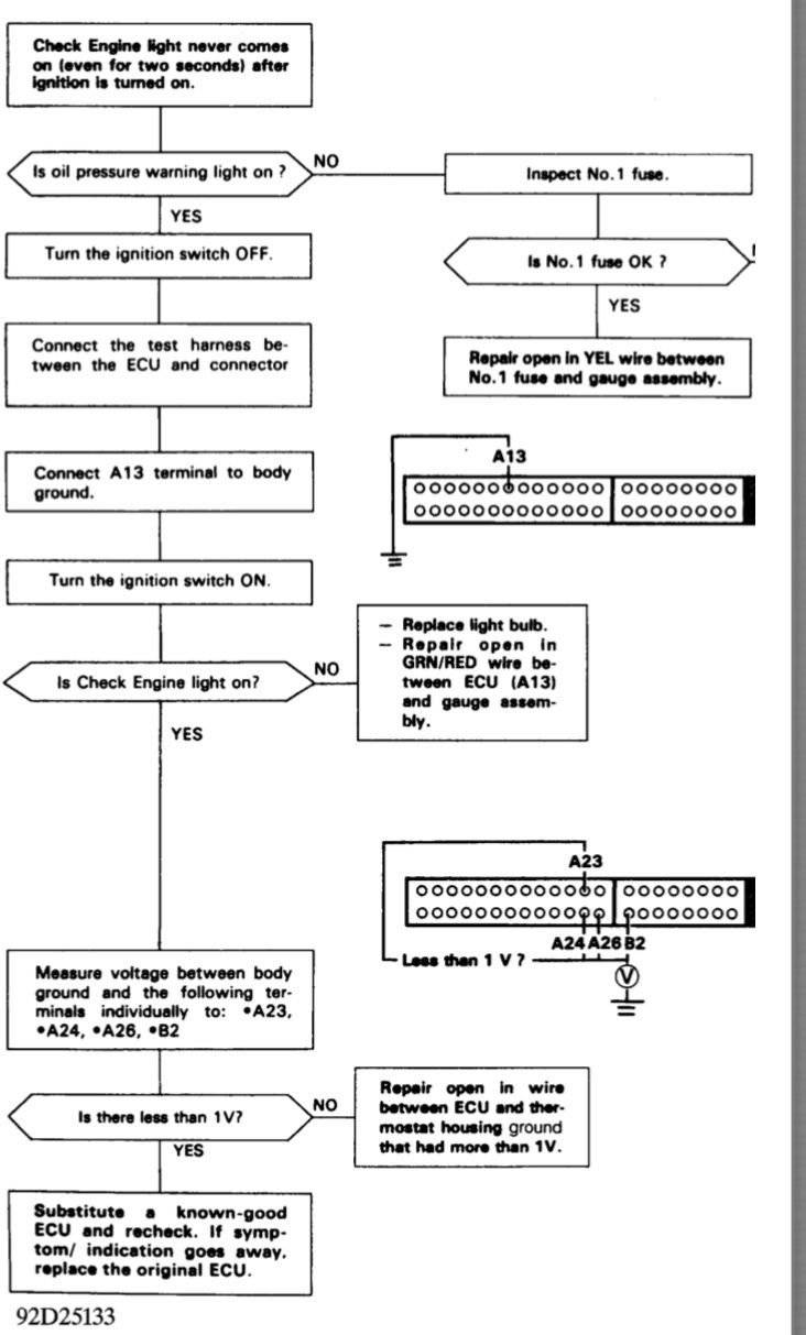

Here is a Honda flow chart for what to check if you’re having difficulty retrieving codes.
That said, keep in mind that problems are often not as complicated as we tend to think. Although useful, trouble codes don’t tell you what the problem is - they just give you a place to start looking.
