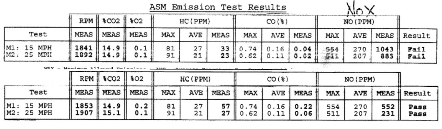

Test results = barely passed...
The top numbers repersent the test two weeks ago when it failed and the bottem numbers are from todays test results. The smog tech told me the numbers look like the O2 Sensor & or the Cat is bad.
What do you guys think?

Congrats on getting your car to pass.
You said that you did the EGR port cleaning. Did you drill out the port plugs and then throughly clean each passage. There are 6 plugs. How many did you remove? As others have posted and my own experience is that this port cleaning has the biggest effect on reducing Nox by allowing the maximum amount of exhaust gases to enter the combuster chamber and reduce Nox. If you did this and are confident that the passages are very clean, then I would try the following to get it to pass by the next test in 2 years.
Also what did the smog tech say your timing was set at.
The spec is 15 degrees plus or minus 2 degrees.
You were right on the edge of failing the NOx, so you will need every bit of help to pass. So right before your next smog is due I would again inspect all tune up items,(plugs,cap,rotor,pcv valve, air filter), change the oil and filter, verify the timing is set correctly. In fact, I would probably retard it slightly (14 or 13 degrees). This will reduce your NOx but will raise your HC and CO readings.
Also drive the car for a minimum of 20 minutes on the freeway to get the cat good and hot prior to the test.
Maybe run a tank of mid or premium grade fuel.
If your numbers were way higher I would look at replacing your O2 sensor or cat but you are so close I would do the above items to get it to pass again.
Thanks for posting your results.
