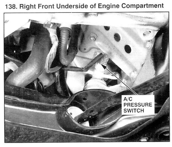

Disconnect the A/C pressure switch and jump the terminals on the connector. If the system comes ON, you've found your issue. If not, you may have a bad A/C thermistor. (common Honda issue)
I have tested the ac pressure switch and the compressor nor fans powered on. I also checked the plug leading to ac thermostat for voltage and continuity and it checked out fine. To go a little further I also measured the voltage between the blue/red wire to ground on the 14p heater control panel and there was battery voltage. Checked the a/c switch for continuity and it was fine. Any other ideas? I am thinking whatever the ac switch on the panel "kicks" and powers up the fans and compressor clutch is haunting me.

At the a/c pressure switch wire harness side connector, the red/wht wire should have 12V to ground (use a bare metal bolt as ground). The blu/red wire should have continuity to ground (use same bare metal bolt as ground). Make sure the key is in the II position when you do this test.
Test for continuity between the two pins on the a/c pressure switch.
