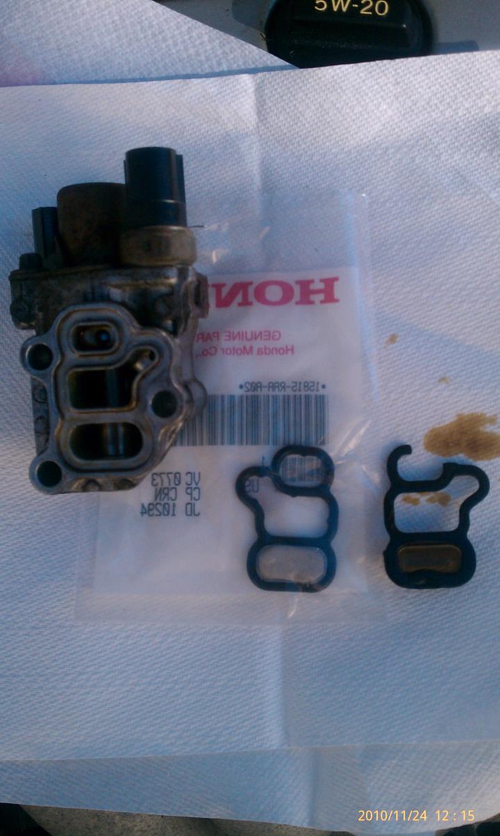

Good news! I fixed my own problem. As suspected it was the VTEC solenoids/spool. I had ordered the seal yesterday and it arrived today. After removing the solenoids I tried removing the gasket and noticed that a small piece of the top of the seal was partially worn and popped right out unlike the rest of it which came out as whole. I took great pictures but since I'm new I can't post them. The job is not difficult and the only tools required are a 1/4 ratchet with small extension and a size 10mm socket short or long your choice. Here's a short run through of whets required.
1. Unplug the 2 connectors on top. Be extra careful with the black one it tends to break easy.
2. Loosen and remove the 3 10mm bolts on the back.
3. Once you have the bolts out you will need to tap on it or pull it towards the firewall/interior to remove it.
4. Once removed you can now remove the metal cover that is held in place by a small 10mm bolt.
5. Remove the gasket from the solenoids or engine block depends where it stuck to more.
6. Clean the part and surface area and install new gasket filter facing in to the solenoid.
7. Install the metal cover using the small bolt on side.
8. Install the top screw first for ease and then the remaining two until they are secure and tight.
9. Plug in gray and black connector.
10. Start vehicle with a few cranks but don't turn it over, retry a second time and allow the car to start and idle for a few to verify leaks or CEL.
11. Enjoy the money you saved by DIY in less than 30 minutes if you read this first.
I did notice one thing while doing the install. First I originally thought the exhaust manifold cover needed to be removed but it did not so unless you need something from that area leave it alone. Second thing is that if you break the tab on any of the plugs simply clean the outer part of the plug to remove any oils or grease. Apply a dot or two of RTV red sealant to the outer base on the solenoid and set it in place. This will hold it in place to prevent it from coming loose but remain accessible if needed; you'll just need a little more strength. Third thing I noticed is that from a cold 40 degree temp start the valves made less noise. This part is not prone to failure but it is the same part that effected many 2008-up accords whose owners complained of rattling noise upon start up when cold. Myself included.
Well I hope this helps someone else save a few dollars and learn new repair.
