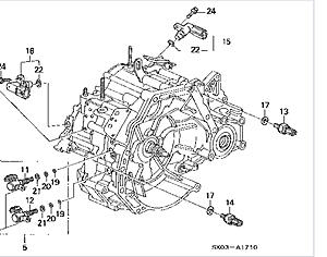

Trying to change my switch assembly but Idk which one is which. And can you guys’ show me the diagram for both? Are they the same with different names? Which one do I buy? When switching to D3 from D4, there’s a sudden delay in accelerating when pressing the gas.

If you trying to get #14 on the diagram then the part number is 28610-RKE-004.
