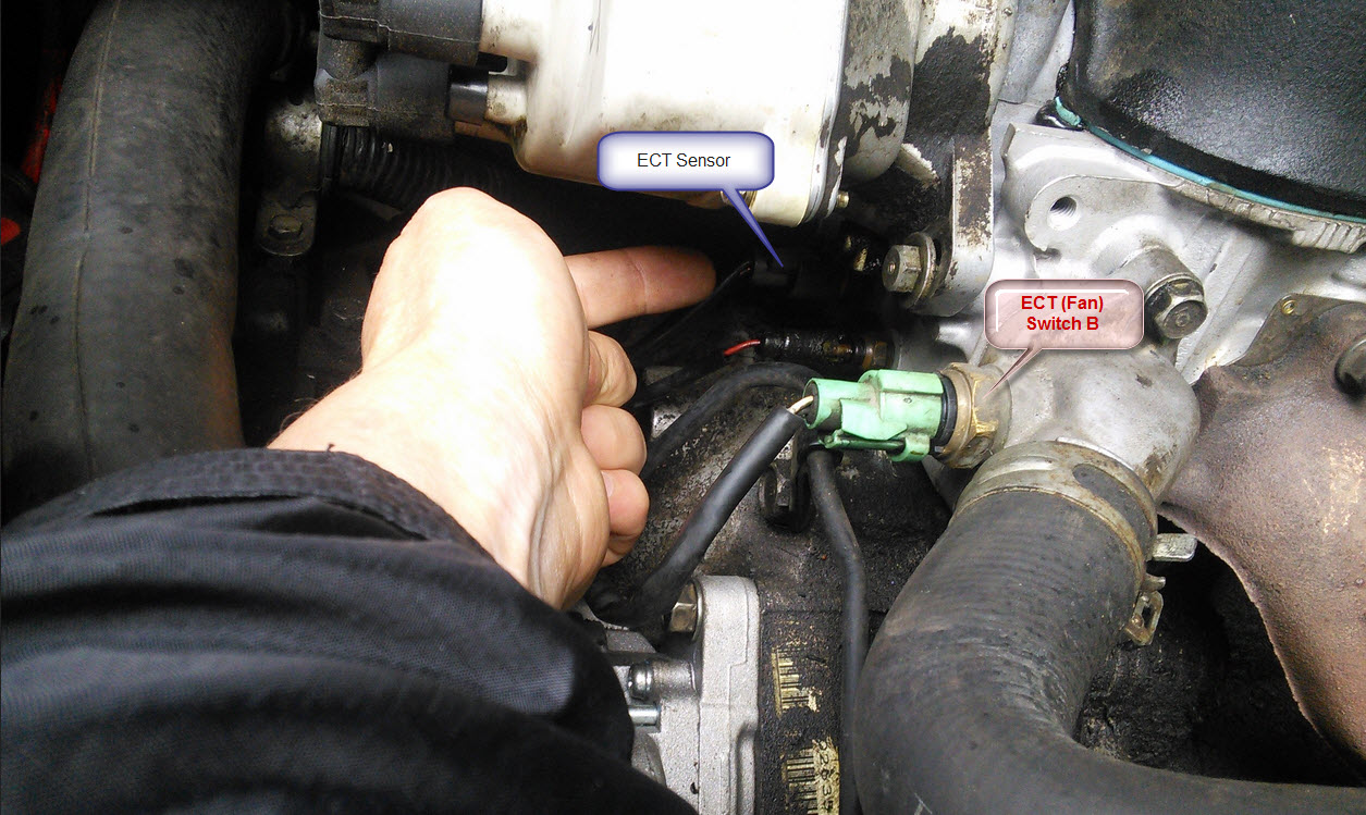

Ok thanks guys. Yeah still overheating at times. The switch near the housing on top is getting the white/green-stripe and black wires. Yes A and B take the same plug but it looks like they are right as the one for A (the one I'm pointing to in the pic) doesn't reach B.
Both fans run when I give each one 12v directly. Passenger side fan runs when I jump B and turn key off. Neither fan run when I jump A with key on or off.
In your photo where your finger is pointing to, that is not ECT (Fan) Switch A; that is the ECT sensor.
The ECT Switch A is not shown in your photo. I've attached a photo of the location of Switch A. If jumping the connector for Switch A with the ignition ON doesn't run both fans, then with a spare piece of wire attached to terminal no. 2 (Blue wire) of the connector, touch/connect the other end of the spare wire to body ground and see if both fans run with the ignition ON.
