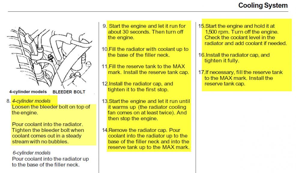

What mikemike stated is relatively consistent with owner's manual instructions. Generally, you pour in coolant while the car is off till it comes out of the bleed valve.
Old May 25, 2012 | 09:24 PM
Posts: 7,101
See excerpt from owner's manual:

You can leave the radiator cap on (but, not all the way tight) or off during the air purge. Owner's manual says to put back on the tighten to first stop, whereas service manuals usually say to leave off. Doesn't make a big difference, as long as the cap is not all the way tight.

Redbull --
Those instructions are CRAZY!
It says to run the car with the cap on until the fans come on twice
Then shut the car off and then open the cap!!!
NO! That is very dangerous.
You never ever ever open a hot radiator cap.
The way I do it makes much more sense.
With the bleeder open, which is at the highest part of the cooling system, any air in the system will make its way to the bleeder and out. Once nothing but a stream of coolant is coming out of the bleeder all air is removed and the system is bled.
Would you disagree with me?

1. With the radiator cap not fully tight, the system will not get pressurized like it would if it was fully tight. So, the chances of getting scalded is minimal. You can use a rag to hold the cap so not to touch a hot cap. Even with the newest Accords (i.e., 2008 - 2012), the service manual instructions says to have the cap loosely on during purging. So, not much danger there. I personally leave the cap off to make it easier to keep refilling during the purging process.
2. Even with the bleeder bolt opened and steady coolant stream coming out of bleeding bolt, this does not necessarily mean all air is out of the system. Most of the air purging happens when the thermostat opens and larger pockets of air start coming out engine block and then the radiator. The reason I believe Honda states to run till radiator fan turns on twice is because that should be around the time the thermostat has fully opened the first time it turns on. -- A lot of Hondas don't even have bleeder bolts.
When thermo-switch A (located on or near the thermostat housing) reaches around 194 - 205 degrees F, the radiator fan suppose to turn on. That would be approximately when the thermostat is fully opened. The thermostat should start opening around 169 - 176 degrees F and be fully opened at 194 degrees F.
