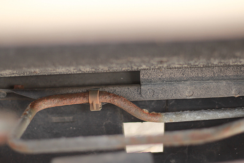

I'll try this weekend. The pipe in the following picture is behind the front bumper. Now I still not sure how to remove the clamp in this picture. And another thing I don't know is if I need to jack the car. Do you have more suggestions? Thanks.
Well, I'd tell you to go from the bottom....there is this "tray" with like 15 small screws that need to come off to get tray out....then gently close the clamp on that clip. However, given the condition of the pipe, clamps and that......that plastic clamp is going to crumble in your hand as soon as you touch it.

Ok, you can buy a new clip for the line from the dealer.
Me, I'm poor. A small piece of 3/8 fuel hose, just an eyeball guess at the size....cut a slit and coat it with lube....slip it over the new pipe......take a zip tie and gently use the tie to hold the slit hose/pipe to that bracket....or agian, buy a ~$4 plastic clip from the dealer.
EDIT: That looks like #7 from the parts diagram, so if you have that on your list already,,,,,done deal.
You must live in the frozen tundra...north of me
I didn't order #7, so if it goes to crumble, you provide me a good alternate way to bind the pipe
I live in IL and salt is widely used during snow day in winter. That's why those pipes looks so rusted...
