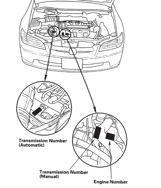

Before doing any more testing, the wire colors are important to ensure you are testing the correct wires.
The number you found isn't helping.
Here is a pic of where the engine information is located.

I still can't find the metal plate on the engine, only "VA" stamped directly into the block, so I will have to keep looking for that, but I can at least tell you for now that it is an ULEV engine.
