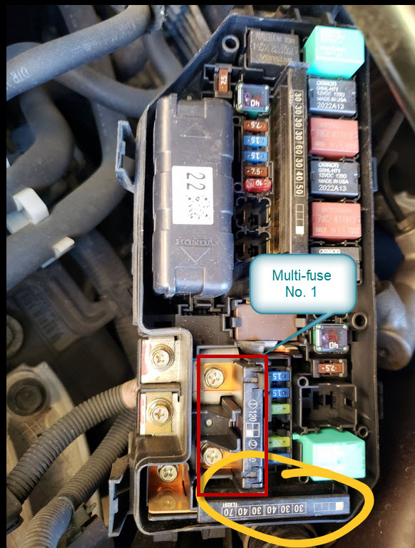

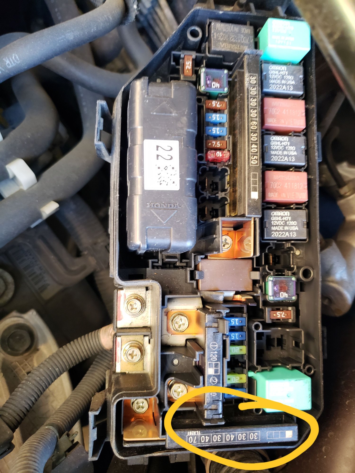

Default Passenger windows and locks as well as rear windows, locks malfunction. Sunroof also

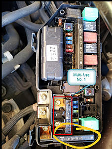

The larger fuse isn't a fuse that you can pull. It seems like bolted in there as an actual relay. I'll upload a picture so you can see. The circles image is what the fuse is.
Originally Posted by JimBlake
That might mean one of the larger fuses is blown. Did you check the fusebox in the engine compartment?
The one in the engine compartment doesnt seem to be one that you can check, it seems to be a bigger part of fuses. I attached a picture so you could see it The circle shows the fuse. I dont even know where to purchase a replacement from

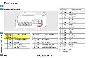

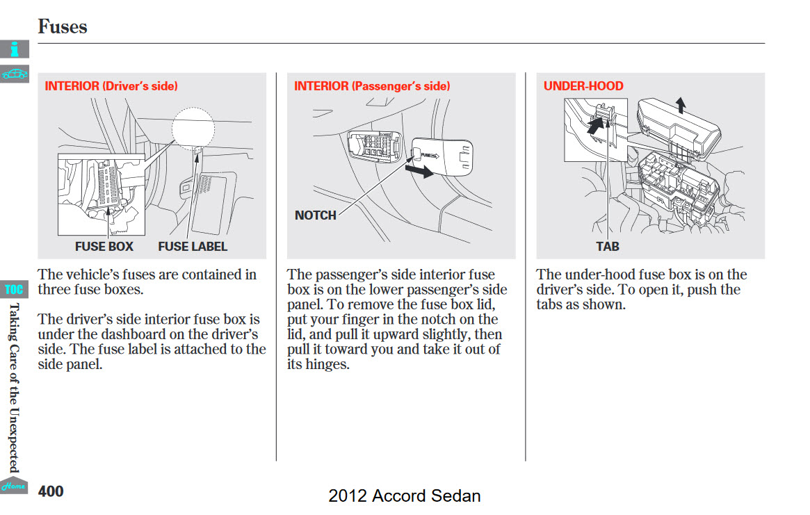

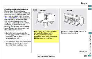

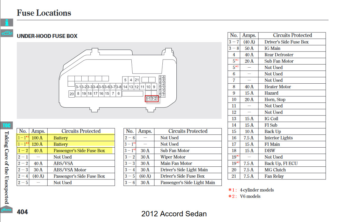

Old Aug 24, 2018 | 07:48 PM
The under-hood large fuse you want to check is Multi-Fuse No. 1 (more specifically 1-2). Multi-Fuse No. 1-2 supplies power to passenger under-dash fuse nos. 7, 8, 9, 10, 11, 12, 13, 20, and 21. Removal is with a philips head screwdriver; the fuse is available via the Honda dealerships.
Also, check driver's side under-dash Fuse No. 5 (7.5A), as that is a common fuse for the items you specified.
Attached Thumbnails Passenger  windows and locks as well as rear windows, locks malfunction. Sunroof also-fuse-boxes.jpg   Passenger  windows and locks as well as rear windows, locks malfunction. Sunroof also-under-hood.jpg   Passenger  windows and locks as well as rear windows, locks malfunction. Sunroof also-large-multi-fuse-1.jpg   Passenger  windows and locks as well as rear windows, locks malfunction. Sunroof also-multi-fuse-no.-1.jpg
