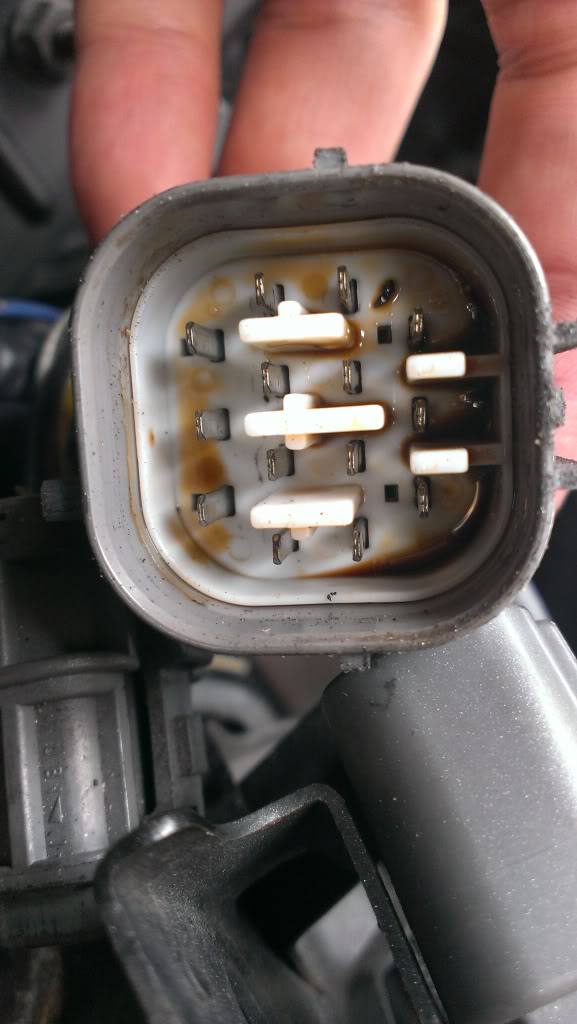

I went ahead and tested the harness, everything checks out, ill replace the dizzy tomorrow.....
I did however come across some unusual finds
this oily stuff wasn't here last week when I checked everything after getting the codes and as you can see, there's no oil or even oil residue on any of Tue surrounding areas, these are connectors that are nest to the fuse box and cruise control.
Is this a discharge of some sort?
I cleaned it with an electrical cleaner from AutoZone, let it dry for about an hour and when I checked again, the oil was there again,just as much as before cleaning it.
I have no idea where it came from. Or how it came back after cleaning it the first time.

That's dielectric grease from the factory and it got hot. There's way too much current running through one or more of the lines in that connector. Which connector is this? Can you take a pic from farther away?
I'm at work right now, ill upload a pic and hopefully its clear enough .
