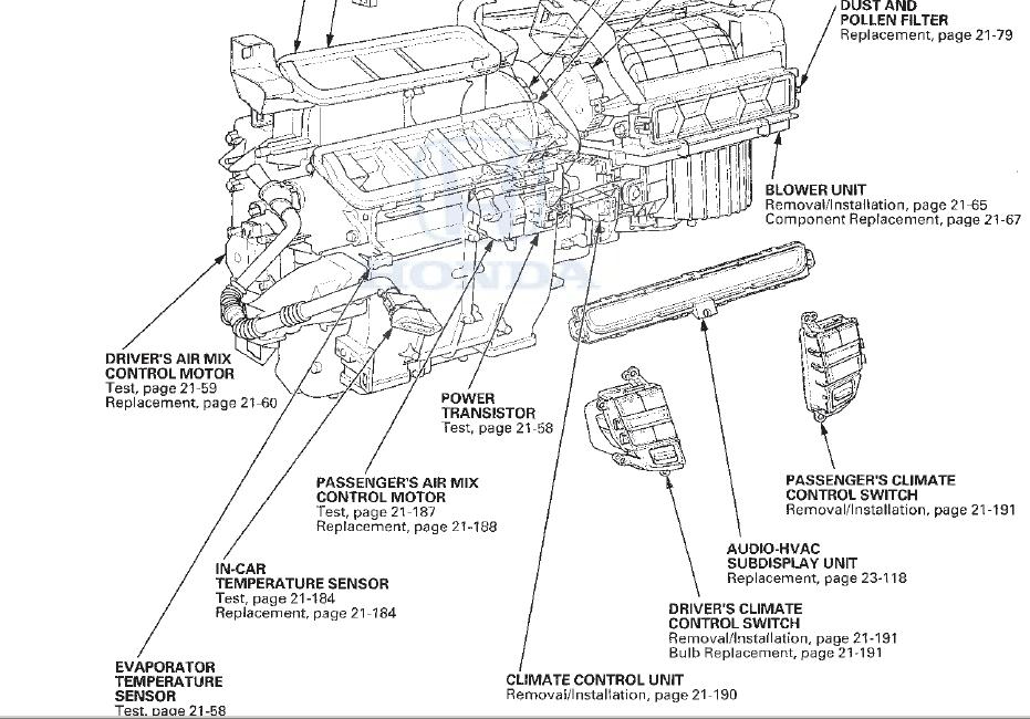

Old Sep 6, 2015 | 06:32 AM
Starting to sound like the air mix motor is "hunting" and the source of the noise.
Does your HVAC have dual controls - drivers and pass side temp settings?
Old Sep 6, 2015 | 06:40 AM
Mikebike125's Avatar
Joined: Oct 2007
Posts: 163
From: Charlotte, NC
Yes, it does have dual controls. I do primarily keep it set on "Auto" and the same temp for both sides. If that matters.
Old Sep 6, 2015 | 06:45 AM
You might try putting your hand, ear - on or near the drivers air mix motor and see if that is the source of the noise.
Attached Thumbnails Pop Rocks crackling sound from the dash???-8th-gen-hvac-box-dual-control.jpg
Old Sep 6, 2015 | 07:57 PM
Posts: 7,101
It usually is due to an issue with the gears inside the air mix control motor.
Unplug the green connector to the driver's air control motor. If there is no more noise, then it probably is the motor.
Attached Thumbnails Pop Rocks crackling sound from the dash???-drivers-air-mix-control-motor.jpg

Ok, so it does seem to be this air mix motor because I am also getting ice cold air on the passenger side and then the temp on the drivers side wanders and goes up and down. It is indeed "hunting.
SO, what is involved in changing this motor? How difficult is it?
Also, I am trying to look up the part and can't figure out what system it is in in the parts finders. I am looking on the Majestic Honda Website and cannot find the part. Anyone know what it is under?
Think I found it. Is it 79160-TA5-A21 013 001 MOTOR ASSY., AIR MIX (DRIVER SIDE)??
Only $30, not too bad. Just need to know how to put it in.
