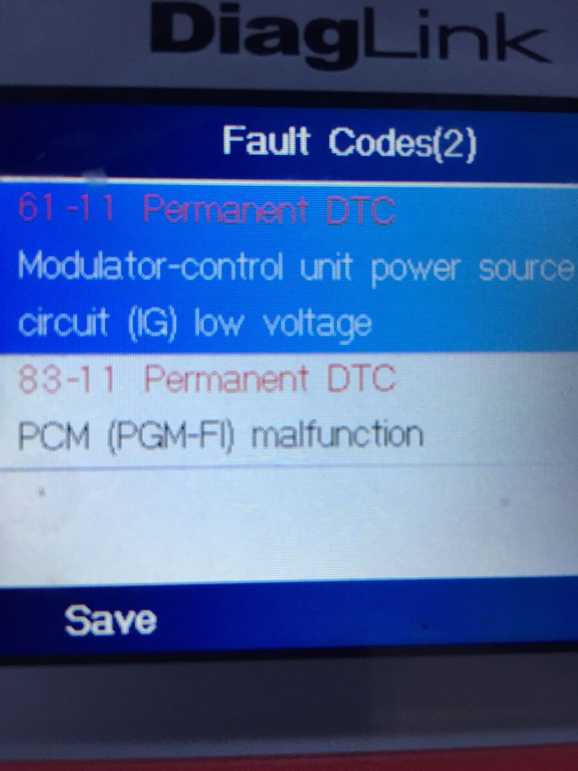

I’m new at this so please bear with me these are the two pictures from the scanner. Also I had a blown fuse in my My AC clutch. It’s a 2.4 L no issues with charging system. Thank you for all your responses and any help you can give me

I took pictures of the scanner.. Like I said none of the fuses work/have no power all sides. Also blew a fuse on the AC clutch on the compressor. It is a 2 L engine.b I took pictures of the scanner.. Like I said none of the fuses work/have no power or sides. Also blew a fuse on the AC clutch on the compressor. It is a 2. 4
https://cimg7.ibsrv.net/gimg/www.hon...0e0a62709.jpeg
https://cimg0.ibsrv.net/gimg/www.hon...839d4e164.jpeg
. Car is been flawless then all sudden lock switch on door will not operate open or close. And key fob does not respond to lock. But does flash tail lights in front courtesy lights one depressed unlock on key fob. Here are the pictures from the scanner. Thank you for any help you can give me. Car is been flawless then all sudden lock switch on door will not operate open or close. And key fob does not respond to lock. But does flash tail lights in front courtesy lights one depressed unlock on key fob. Here are the pictures from the scanner. Thank you for any help you can give me

This was a good read. Being that certain things aren't working it seems like the MICU is in a fail safe mode meaning it detected getting less than 10v at some point. The read is from a Honda Fit should be the same across the board
MICU
Capt.rick34953 Jan 19, 2020 07:07 AM
I live Florida. Nice car has Zero corrosion. I did plug in 2006 trunk latch to trouble shoot. a trunk light Light . it lite up then unplugged and these issues started. i have a spare fuss box with a micu i will install and see if the issue clears.do not look like fun job. Then deal with the immobilizer.
