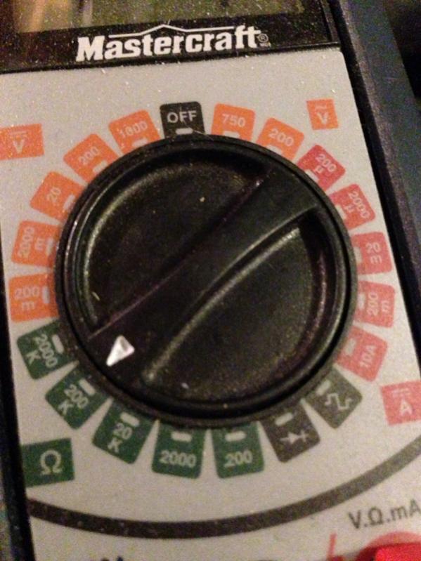

I hooked up the voltmeter and with the setting on 200k with engine cold and key in thieving position the reading was 00.4
Does this mean it is good or bad ?
Old Oct 16, 2013 | 05:44 PM
1994-Texas-LX's Avatar
Joined: Aug 2013
Posts: 23
* in the off position ( not thieving !)
