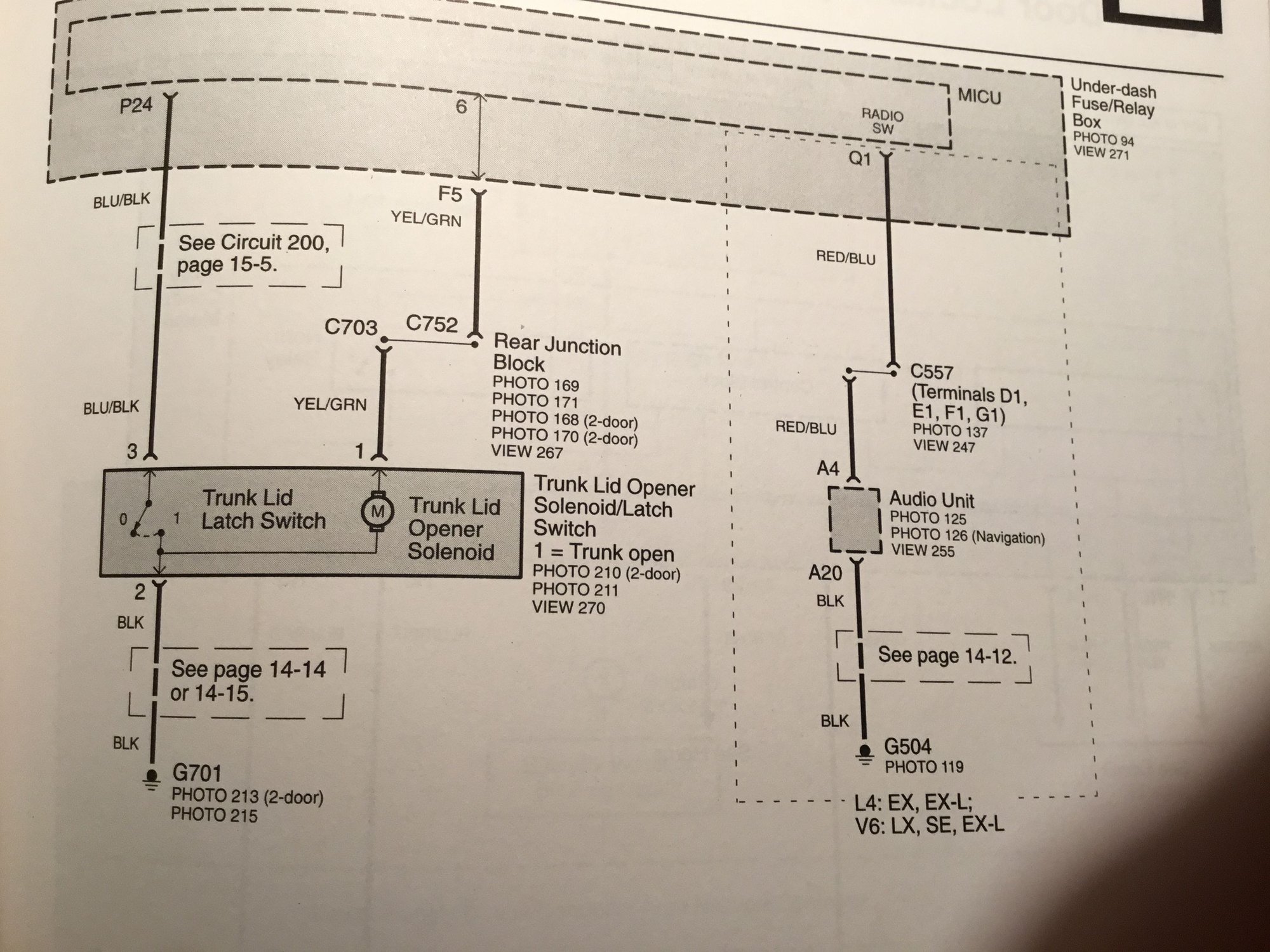

Hello Colleagues ,
I have a problem with my Honda Accord 7th gen wagon 2005 year. The trunk lid doesn't open from a remote control. I found some broken wires and recovered them, but the trunk doesn't open yet. I think that some supply voltage is missing, because when i push the button to open the trunk lid I don't hear the motor moving. I checked all fuses and they are OK.
Other possibility is the control unit under the roof being blown up, because there were some broken wires , which could be short-circuited.
I will be so grateful If anyone would share wiring schematics for control of trunk lid !
Thank you in advace !!

Hope this helps:
