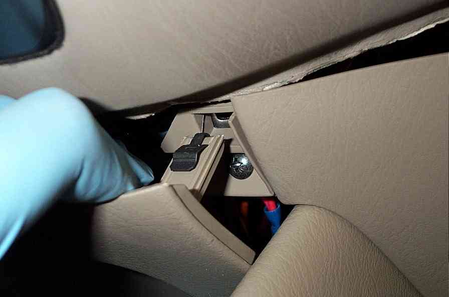

Ok, i decided to change my aire filters but damn its been tough for me... i removed the panel below the glovebox but this little screw you see in this pic: www.syclone.motocrew.com/CG5/acfilter/ac1big.jpg fell and now i need to remove the center panel to get it. With a flat tip screwdriver i poped off the front part but i cant remove the back... as i can see it does not have screws but i just cant pry that thing off, are there any more screws or i just have to give it a harder tug???!!

that didnt solve my problem, i dont want to remove that panel... the one i want to remove is the one the guy is pulling in the pic i posted...

That panel has 4 clips, one at each corner. Pop out the top 2 then reach in the bottom, grab, and pull. They can be a bit tight.

yeah, i got pissed and pulled and they got off! Now i encountered another problem... 2 screws holding the metal bar infront of the filters are to tight... ill give it a try tomorrow morning with an electric drill.
