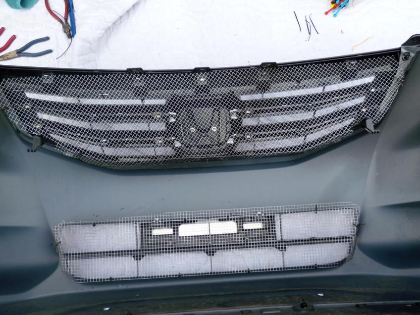

With only 1600 miles on my 2012 Accord LX-P, a rock hit my A/C condensor and took the condensor out. The local dealer (Round Rock Auto Group) said it was a road hazard and initially refused to cover the repair, calling it a road hazard. I threatened to take Honda to small claims court, pointing out that many Accord owners have complained about this problem. The service manager caved. Nonetheless, Honda has a serious design flaw. The A/C condensor is not protected by a screen. So after the local dealer replaced the condensor, I fashioned a screen to protect it. Used a screen with 1/4" holes and connected it with zip ties and bailing wire.

The lower grill (or bumper) opening on the Accord is really critical. On my Accord, that opening is huge; before installing the screen, my whole hand fit through the opening. I looked at my other car (IS350) and it has a plastic screen inserted in the lower bumper opening. Pic attached.

This is definitely not just a Honda thing. I know Nissan and Ford trucks have large openings in the grills. I had read a lot about rocks taking out Accord condensers, so I made this out of expanded metal. The top part is mainly for looks/continuity.

Just took a pretty long road trip. When I washed the Accord after returning home, I discovered the screen I installed stopped a rock of decent size.
Here's a link to a high-res pic of the rock caught in the grill- P1010553 stopped a rock | Flickr - Photo Sharing!

Did you have to remove some of the existing grill to get the screen on or could you get to it underneath?
I had to remove the front bumper to install the screen. It sounds hard, but it's not- two screws and a bunch of plastic clips.
