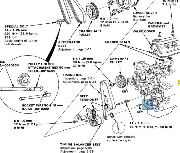

Question Question on Photo from Manual
Question on Photo from Manual-crank-pic....jpg explanation on sticky note in picture...

Thumbs up better pic
Question on Photo from Manual-crank-2.jpgmaybe this is a better pic ...
Old Jan 2, 2011 | 07:23 PM
That's the actual crankshaft.

Thumbs up Nice...
Nice pic... the manual i downloaded didn't give many exploded views of engine. Was that from a paid for manual? Had a hard time trying to down load some other manual. So that is the Crankshaft...ok cool. Im just trying to get more info for my self for when I talk to the mechanic. Im beginning to understand my problem more, looks like some one tried a quick repair of the pulley, maybe had a broke of bolt and pin, will find out this week... Could u give me the name or local of that manual you have ?? ty for the info...dave

www dot hondaautomotiveparts dot com
click PARTS
put in your car's information
this picture is called something like crankshaft/pistons
I think that's from Honda's electronic parts catalog, because several on-line dealers show the same pictures.
