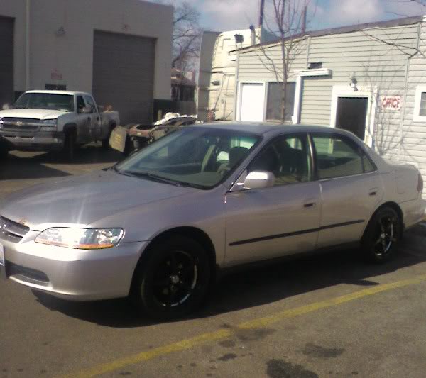

i just bought the car a couple weeks ago and it was overheating so i replaced the thermostat and water pump i let the air bleed out of the car and what is happening is that my radiator hoses are getting so tight at times that the bottom hose leaks a little im lost and i really want to keep my car. help how do i FIX THIS?????
