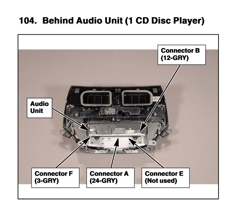

The harness Connector B is different for an OEM 1 CD player vs an OEM 6 CD player.

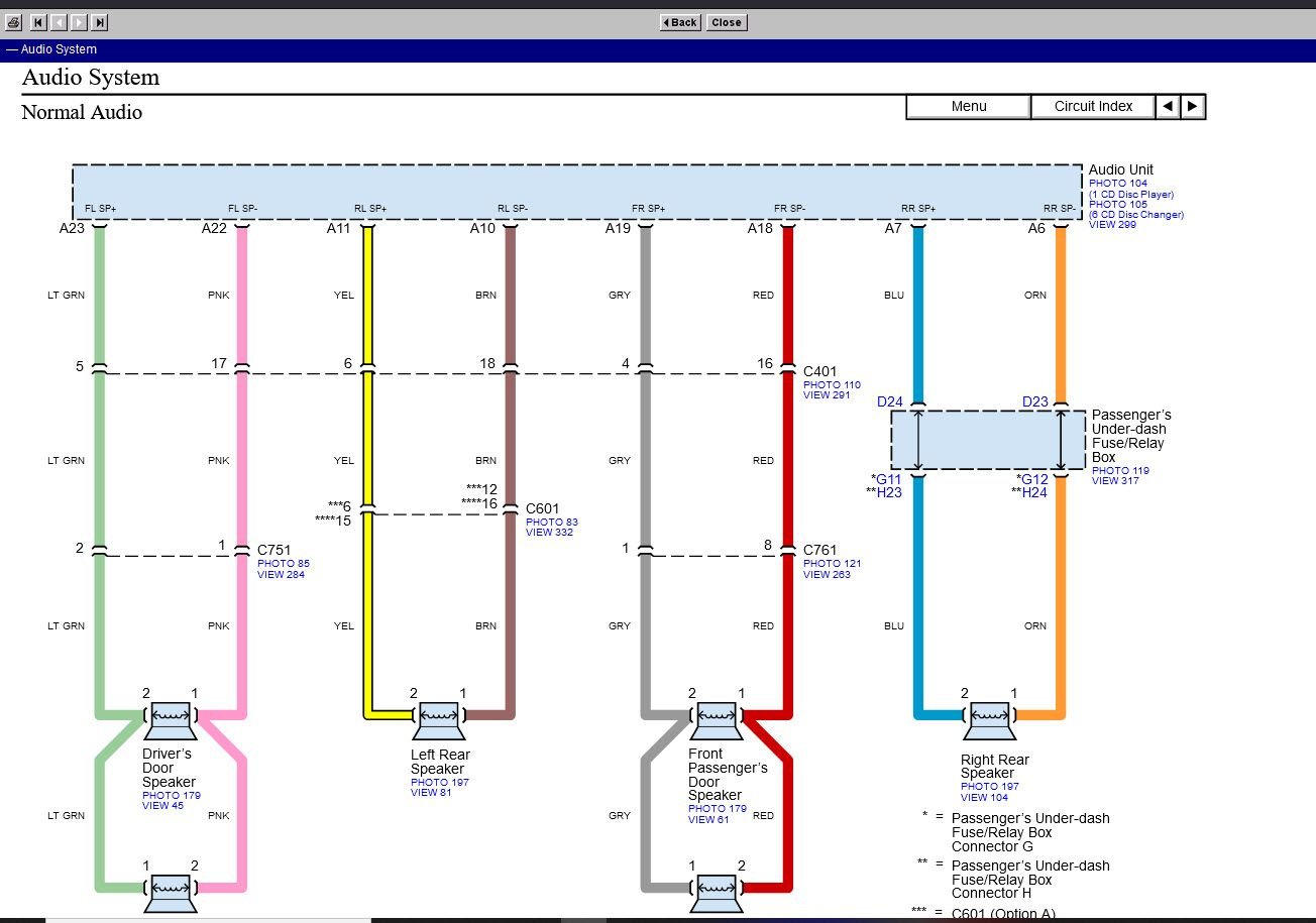

I saw this video from a Honda service center for my year and model but does not specify trim. I have a single disc cd player and I think this is for a 5 or 6. that says there is a factory amp for the speakers. Can you take a look and comment? Thanks if you can;
. If not you can go to YouTube and just type in “honda accord amplifier removal” and you’ll find the exact video on a 2011 accord factory amplifier and where it goes, etc. Would it make sense that an amplifier would have its own fuse somewhere?

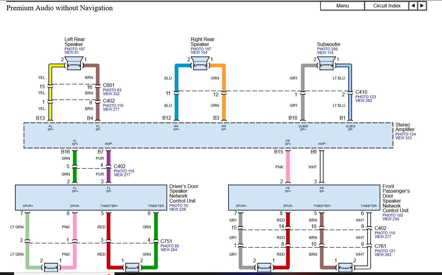

Old May 2, 2023 | 05:07 PM
Posts: 7,101
The 1 CD normal audio system does not have a separate amp. Honda circuit diagram do not show a separate amp.
The separate amp is on premium audio OEM system, which is not what your LX has.
Old May 2, 2023 | 05:36 PM
Posts: 7,101
What I previously posted in this thread remains the same.
Old May 3, 2023 | 08:16 AM
Amlutz24's Avatar
Joined: Apr 2023
Posts: 10
Hey Redbull-1: YOU’RE THE MAN!!! Great advice. Right on the money. Thanks for the diagrams which helped me understand that my system is too basic to have outboard amps, etc. Now I know for sure that there is a blown channel or circuit in the radio itself, which I can now replace with confidence. Thanks again.

Hey Redbull-1, I saw on the right side of the normal schematic an area marked “Passengers under dash fuse/relay box”. Might a problem in that area cause a problem? Thx again.
