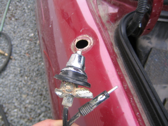

I took a picture of my old busted antenna. I think it probably already is an aftermarket replacement as it has a little sticker on it that says made in China.
I looked at the Car"parts" store website and didn't see that they offered any kind of manual antenna replacements for my vehicle either. I suppose if I could come across another cheap-a... replacement style like my old one that busted that would be fine, or will cough up the big dough for the OEM. Probably end up biting the bullet for the dang OEM though.
Old May 31, 2015 | 02:48 PM
  #17
That looks like just the "mast" has broken.....meaning unscrew the nut at the top and see if you can get the last bit of the mast to "un-screw" from the base.
If so, just get a new mast -verify threads and pitch - screw in new mast....done. Well I might add a "dab/coat" of silicone to the underside of the rubber part where it seals to the body....that part at the "top" of the car is "leaned in" - factory - and can lead to water issues...which I hate

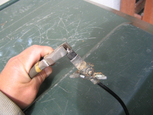

Okay well here I'm gripping with the pliers what seems to be the broken leftover stub of the old mast. I tried holding the other part of the business firmly and solidly while turning/twisting trying to unscrew the stub with the pliers gripping it. It doesn't seem to want to unscrew and the harder I try to grip the broken stub with the pliers the more that little stub just crushes. Maybe this aftermarket antenna isn't made for the mast to be able to be unscrewed. Although that would be nice because then I'd just need to get a replacement mast as suggested and I would think those might not cost much, if I could find one.
Old Jun 1, 2015 | 06:03 PM
  #19
Could be, I'm use to the ones that would "un-screw".....my bad for leading down a wrong path.
