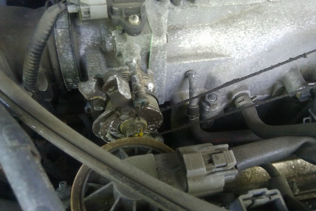

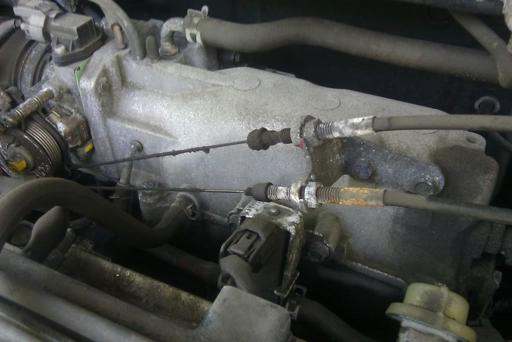

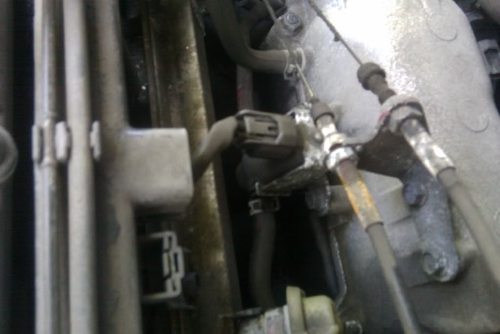

Alright so here are some pictures of what I thought was the spool valve. I could be totally wrong but hopefully I am not. Take a look and tell me what u think.

tell me if that is it or if not i'll try to find it again. sorry about posting really big pictures. it just happened that way.

Spool valve isn't in there. Look for the triangle flange with 3 bolts. Little metal can in the middle sticking up with a single wire.
Hold the camera in about the same position, but shoot straight down not back towards the firewall.
