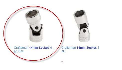

Try the Sears Craftsman 14mm flex socket. They have two somewhat similar looking sockets, the flex is shorter on the socket end, so it may fit in there better. It doesn't need as much room as the longer one. Use an extension on the end of it.
I noticed some of my Craftsman sockets were even thinner than some of my Snap-On thin wall sockets (not most, only a few).
6-point is better than 12-point to prevent rounding the bolt head.

I don't think a swivel attachment will work here.
