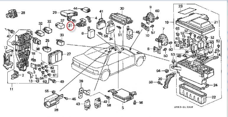

Look for the chime behind the driver side kick panel. Try disconnecting the 2-P connector.
