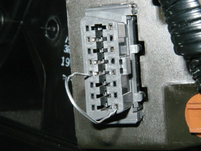

I'm not a fan of clearing codes before I know what they are.....but at the same time I have done it more that once.
Never used the "jump" on an OBD_II....most of the 96's still had the "service" connector under/behind the glove box like the OBD-I Accord's.
A simple code reader can be had for not that much...less than $30 last time I looked and with the "fleet" you have and the willingness to do your own work, would be something I'd put on the wish list.
Behind the ashtray.......USE AT YOUR OWN RISK !!!!!

My 96 has both the blue connector behind the glove box and the obd 2 behind the ashtray,,which one should i do?
Old Jun 7, 2015 | 01:11 PM
If you don't have a reader.....I'd feel better using the "blue service" connector behind the glove box.
There are tons of "conflicting" info on jumping the OBD-II connector..
