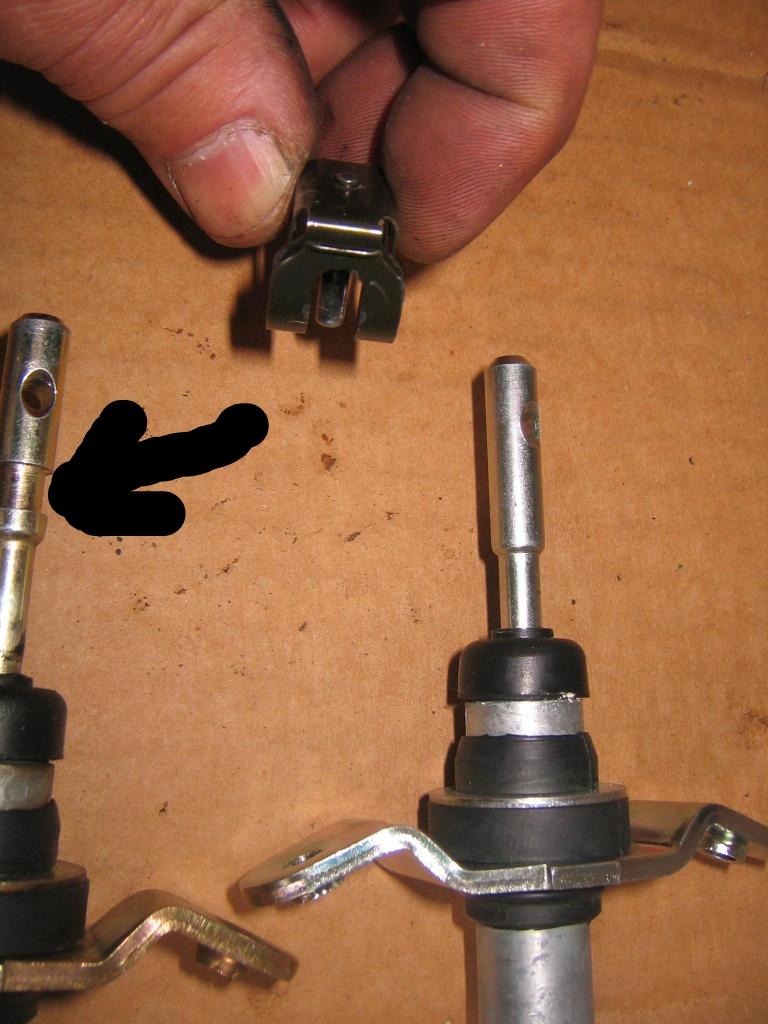

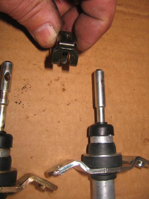

I purchased a new shift selector cable which goes between the shift selector lever and the automatic transmission of my '92. I've noticed now that the shift lever connection end is different as compared to the original. Everything else is absolutely identical about it, however, no other differences. The pin lock clip cannot fit onto the new shift cable end because of the difference as shown in this picture (notice the slot in the shaft on the old part on the left as compared to no such slot on the new part on the right).

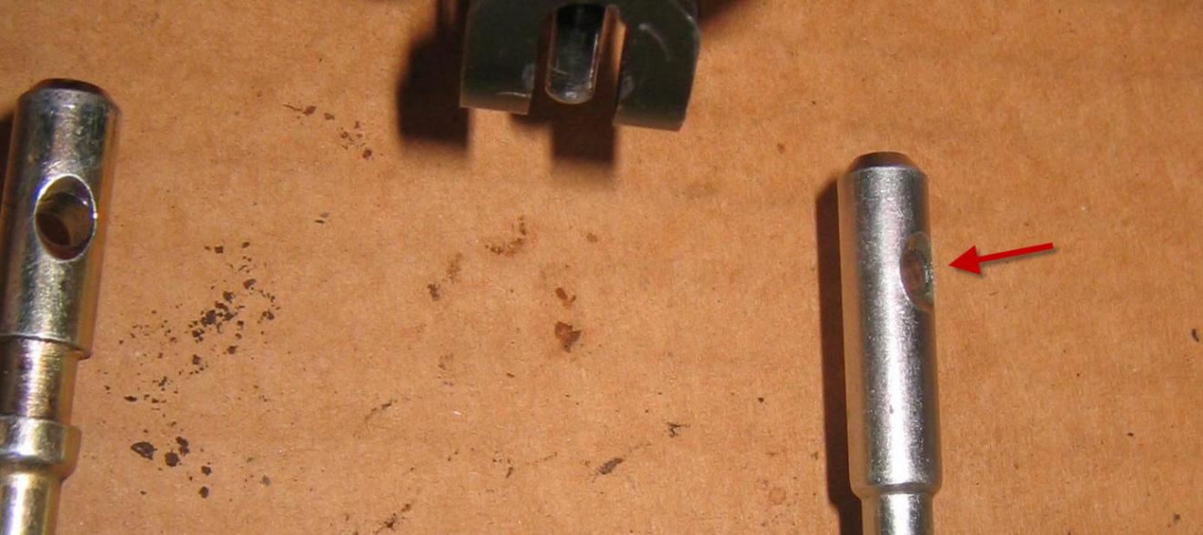

I can't tell for sure from the angle; but, they didn't drill where that indentation is?
No, they drilled where your arrow is pointing. So no issue there.
Note where I've drawn the arrow in this picture. See how the shaft has the is skinner portion in that short length of the shaft where the arrow is pointing? That's where the clip needs to fit into.

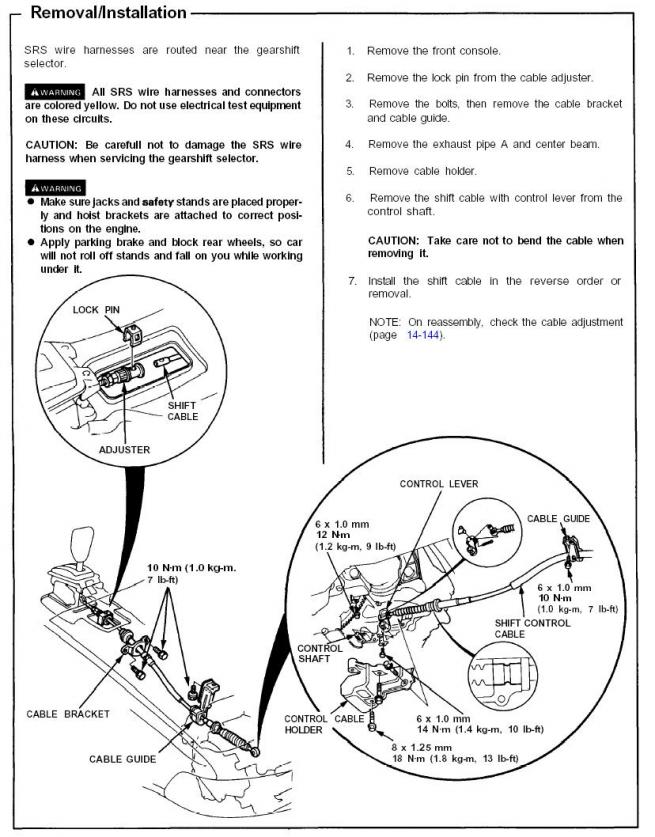

Does yours look like the image from the service manual (see pic.)? From this pic., it kind of looks like the lock pin would go over the part with the adjuster and slide into the hole on the shift control cable.
Yes, looks the same as your image from the service manual. Yes the lock pin does go over the part with the adjuster and the pin fits into the hole in the shift cable (with the original one, but with the replacement part I purchased it won't fit down over the end shaft connection portion of the cable assembly). Where I've drawn the arrow pointing (in the picture I've provided in my last post here) you can see that the shaft, as I described, has a skinnier (notch) portion there where I'm pointing. That width is the width of the open slot you can see in the front of the "lock pin" part I'm holding there. Without that notched out section (the new part doesn't have that notch, you can see) the open slot of that lock pin cannot fit onto that connection. Without the notch, the cable connection pictured is simply too wide for that lock pin to fit onto.
