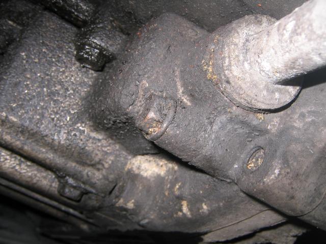

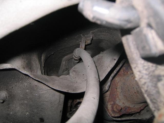

My statement (quoted above) from my last post here is a mistake. I was mistakenly reading from the manual transmission cable adjustment when I posted that. Actually, for the automatic transmission there's only one cable that goes from the selector lever to the tranny. I've removed the console and checked things out and have determined the problem does indeed seem to involve the cable itself and not friction or other mechanical issue with the actual shift lever. Therefore I've went ahead and ordered a new replacement cable. Because my manual does not describe details of replacing the cable, I was able to get a fairly good idea how to go about the replacement from some instructions I found online. The cable runs underneath the body of car starting from the shift lever/console area where it's fastened with a plate situated on bottom of the car body directly above the exhaust pipe and its lightweight metal heat shroud. Apparently if this shroud is loosened it can be moved backward/downward just about enough to get a ratchet up in there to remove the screws holding that cable plate. I took a picture of that area from under the car; I need to get back with my ratchet a little farther than that that bracket shown in this picture. Looks rather tight for sure, I hope just moving that shroud will allow enough room for access because I certainly don't want to have to lower the exhaust pipe.
Here's where the end of the cable goes into the tranny. There's a cover on the tranny housing that needs to be removed to disconnect/connect the cable. Looks to be three or probably four bolts holding this cover on, but just looking at it seems like maybe trying to remove one those bolts (there toward the back of the picture) may complicate actually removing that cover as it holds another thin metal shroud-like piece on the tranny or something there.
I guess I won't know much more until I actually get in there and start trying to remove this stuff, but if anybody with some experience doing this might have any advice/comment beforehand I'd certainly welcome it. Thanks.

So you did check the "adjustment"? Anyway, not sure if this pic helps any or not.
Yep, I did check the adjustment as described in my Chilton manual. That looked to be fine and adjustment apparently not required.
The diagram/picture does help, thanks. Gives me a clear idea about taking that cover off and what's under there.
