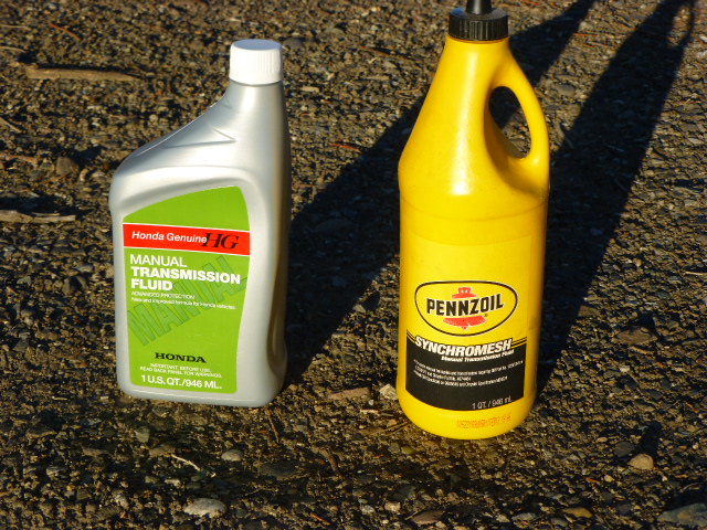

A 5spd driver here - both of these tranny oils work good for me with the Pennzoil product being a bit better in the cold temps.
So, if in cold temp Michigan, I'd probably mix Pennzoil with Honda 60:40.
Best wishes. Change the fluid - it's cheap.
