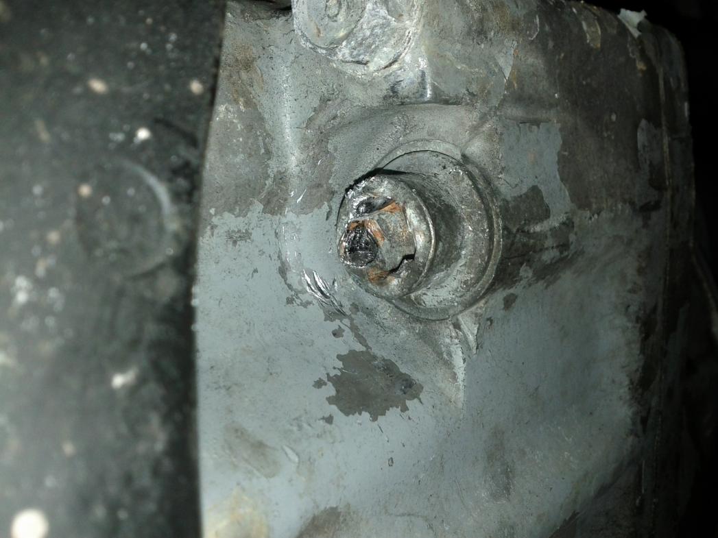

So I went to perform an ATF drain/fill on my '02 and was pissed to see the trans. drain plug have a stripped head My car had the infamous Accord trans. failure at 137k miles so I had AAMCO put in a rebuilt unit about 30k miles ago. It's upsetting that those idiots put in a unit with a jacked up drain plug. So a simple DIY that shouldn't take more than 20 min has become a drawn out chore. Does anyone have any relatively pain-free ways to remove this thing? I really don't feel comfortable blow-torching anything and want to be careful to not damage the transmissions's aluminum body. Thanks in advance.

I'll put up a pic after work tomorrow. The square hole is chipped and rounded on top; when I firmly put in the 3/8 in ratchet and crank it counterclockwise, nothing happens but the hole getting more deformed.

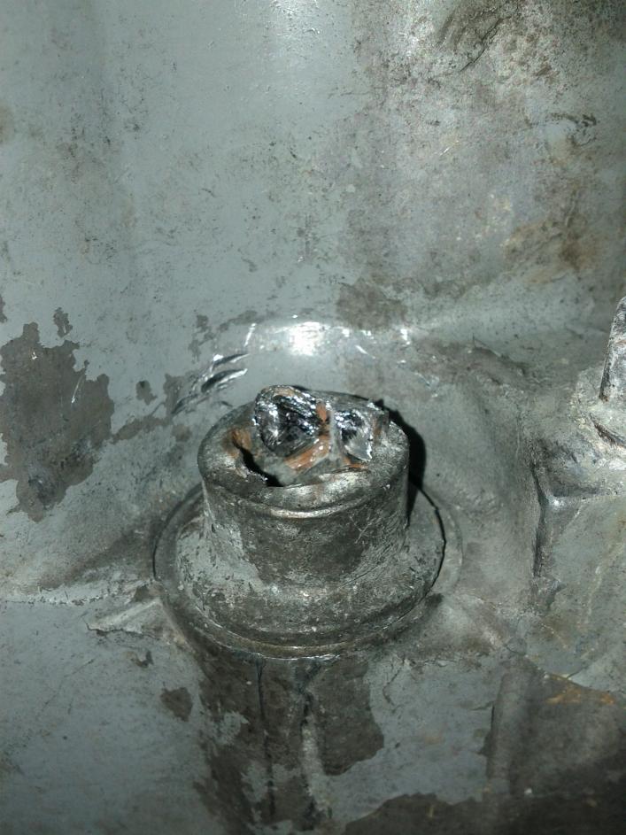

Here are some pictures of the offending bolt. I tried using a vise-grip but there just isn't enough room for it to properly bite down on the bolt. You can see some of the marring the vise-grips caused in the surrounding areas of the trans. body. I tried using a 3/8 ext but again there was a clearance issue as it hit up against a metal support piece of the body. I'm just considering taking it to my indy and having him deal with it.
