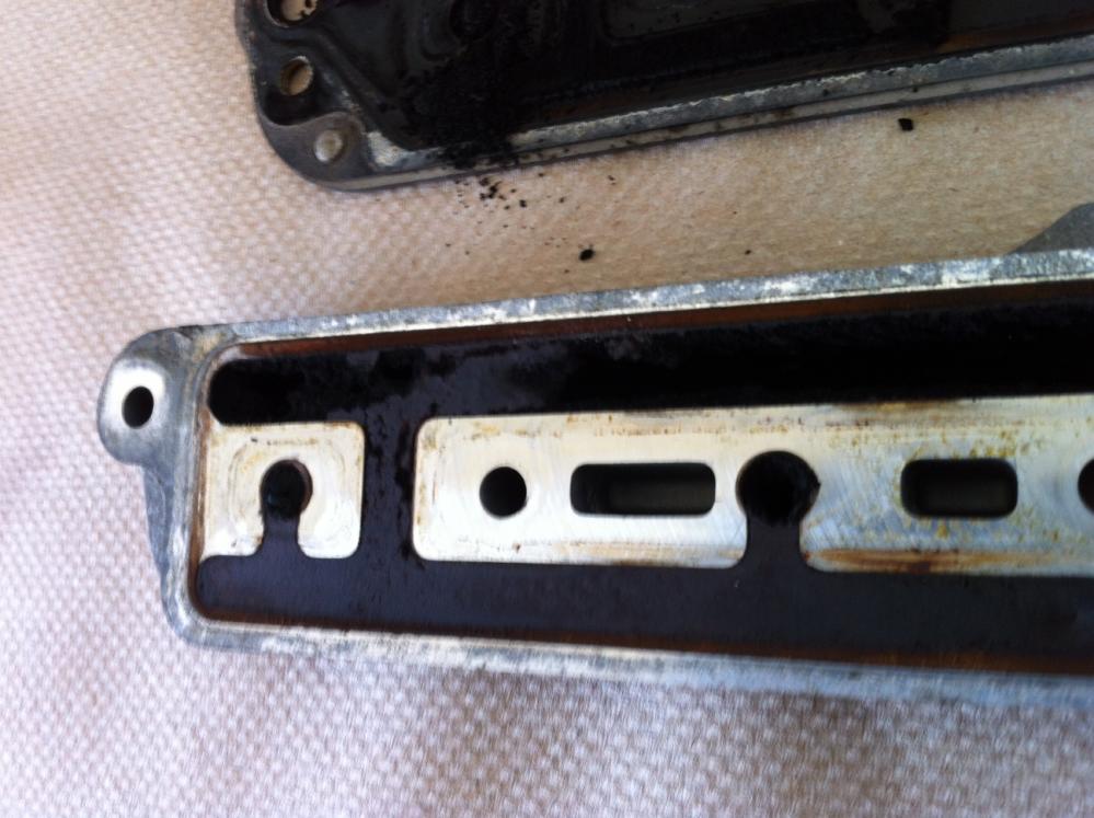

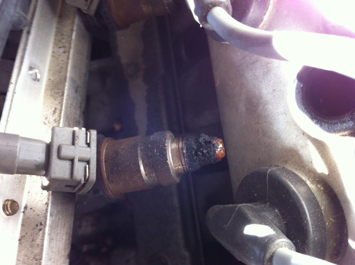

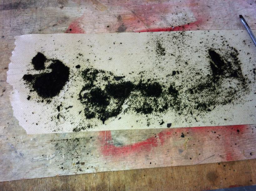

The pictures below show the injector neck were all pretty dirty. The nozzle itself inside looked all clean. They are the original injectors so I have no idea if they need to be replaced or not. You can also see the carbon build up and the pic of the carbon scraped out is HALF of what I actually removed. It was worse then I expected. This was the first time Ive ever messed with the fuel system at all and I was a bit nervous making sure it all seated properly when reassembling. I assume I did it right because after it stumbled to run for about 4-5 seconds, it leveled out and ran fine. I drove it around the block twice and see nor smell any fuel leaking. I filled up this morning and added a can of B-12 Chemtool to the tank. Is there anything else I should keep an eye out for or check? I guess when I head to work tomorrow if I make it 50 miles to work without a car fire then I'm good.

Did you clean the EGR injection ports in the intake manifold, below the EGR manifold? This is where complete blockage usually occurs.
Very dirty Injector head. I would inspect PCV system closely and insure it's functioning correctly.
Old Jan 29, 2012 | 01:40 PM
Biggest thing, no leaks...external or internal (air getting past the injector in the intake). If the "cone" was clean (one pic it looked that way) then you should be good to go with the injectors.
When you get to work, take a good smell....then when you get home, pop the hood-I'd leave it running- and give it another good look over.....call it done!
Yes, I found a thread on here by Hondadude I think that had me use a drill bit and hand drill out the blockage. They were totally blocked below the manifold I removed. I drilled them out and vacuumed up as much as I could.
I had replaced the PCV valve awhile back and it is still functioning well from what I can tell. It rattles freely when i shake it. What else should I look for there?
About a year and a half or so I did have the oil in the spark plug wells and had to have the top and bottom portion of that repair fixed. Would that contribute to the dirty injector heads? They are the original at 222,000 miles now. I have no check engine lights or performance issues.
I did gently wipe off the carbon from the injectors and inside each of them on the tips were totally clean and shiny silver. I'll do just that, thanks!

As engine ages, blowby from engine increases crankcase pressure (lowers vacuum level). Under acceleration, reverse flow from crankcase to PCV air intake occurs and can contribute to the coking you see. Not much can be done other than make sure PCV hoses and valve are clean. Air filter should be clean also to allow minimum pressure loss across filter.
Note, some amount of reverse flow is inevitable under heavy acceleration.
