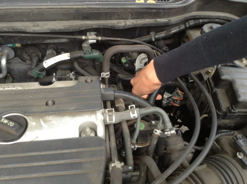

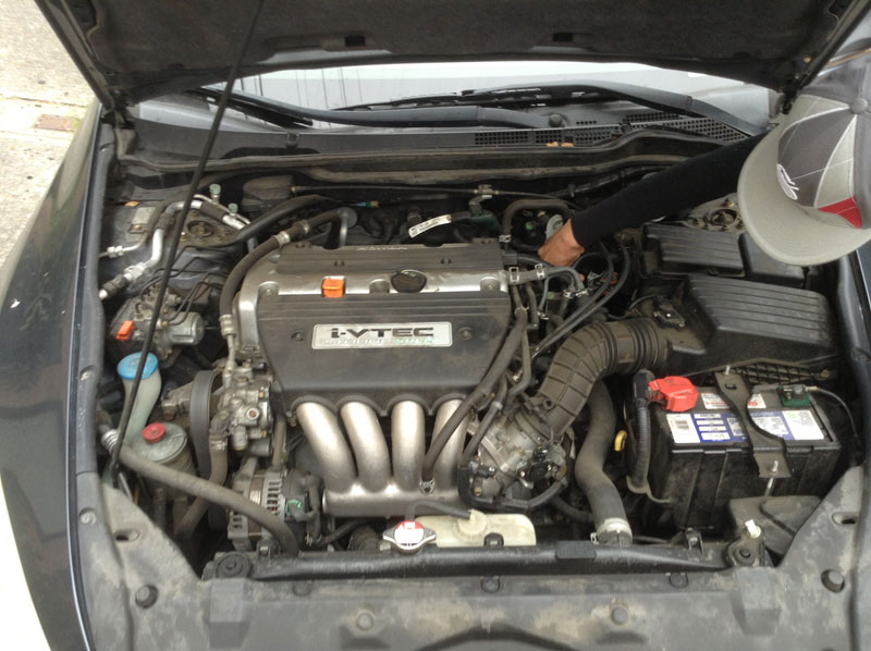

I disconnected a major wire connector under I think it's the TPS in the engine bay. Its probably a 20 or 24 pin connector and i could snap a pic but my gf took the crippled car. This is a four connectors plugin area about 3/4 to the back of engine bay up relatively high behind the motor. It was the one carrying the green wire with grey dots painted on it that eventually makes its way after several split offs to the transmission range switch.

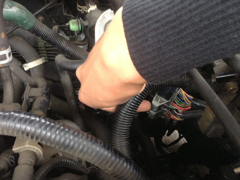

Default ONLY way shifter can go into reverse and not blow fuse #21.
As pictured below - this is currently the ONLY way I can put car in reverse with AT shifter and not blow fuse #21. I have to disconnect this connector - the one pointed to - it's the upper connector of the two there.
It may be meaningless or insignificant. (?)

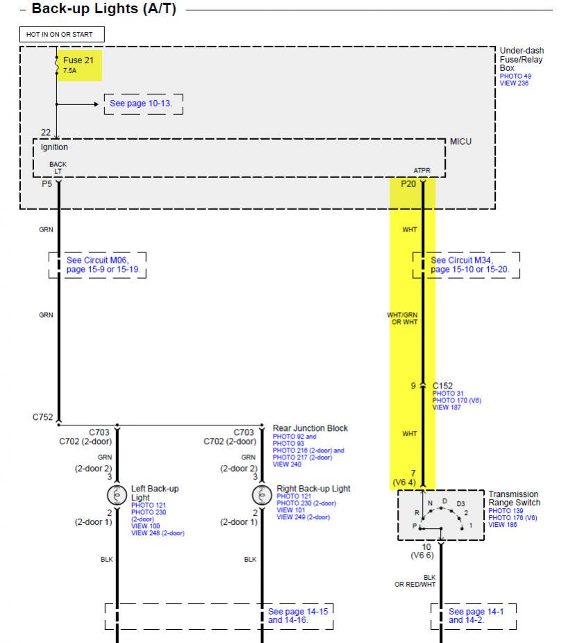

Does that fuse also feed the back-up lights? That looks like the trans position sensor, so how about a short in the circuit for the backup lights? (Its a long thread so maybe you've already ruled that out)

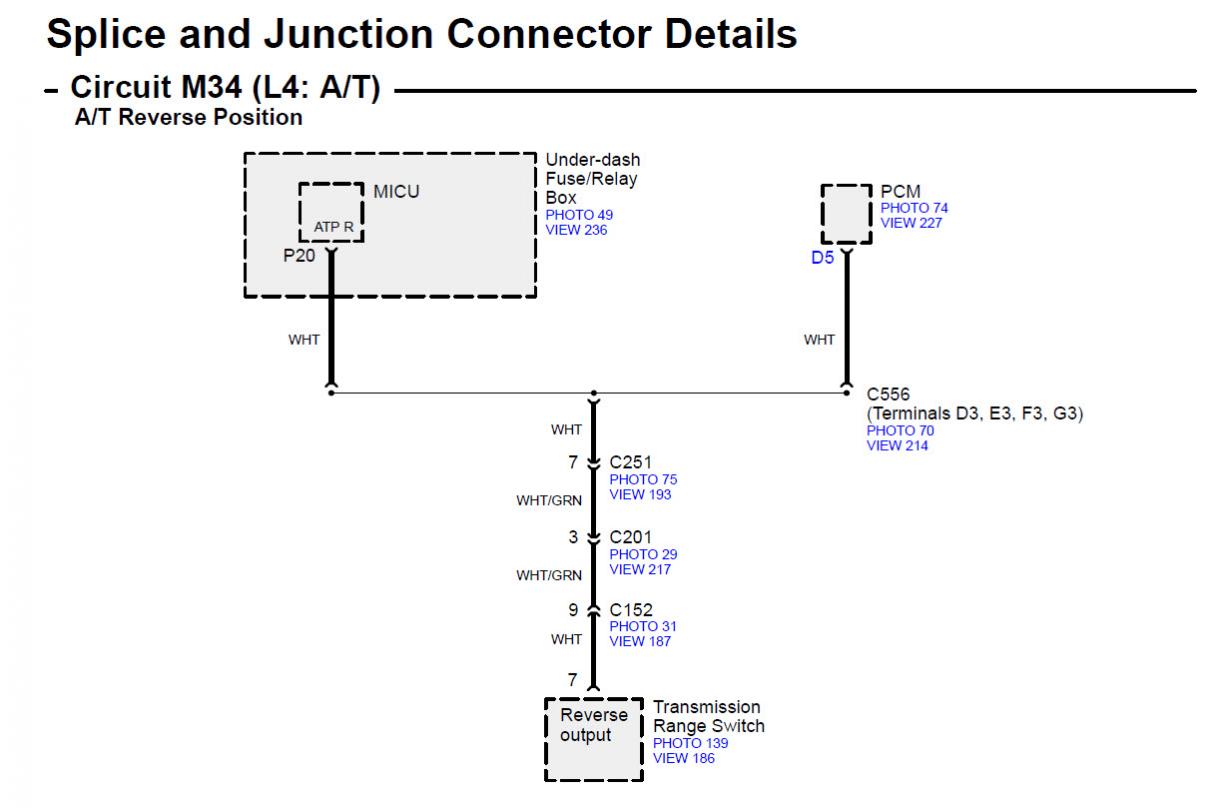

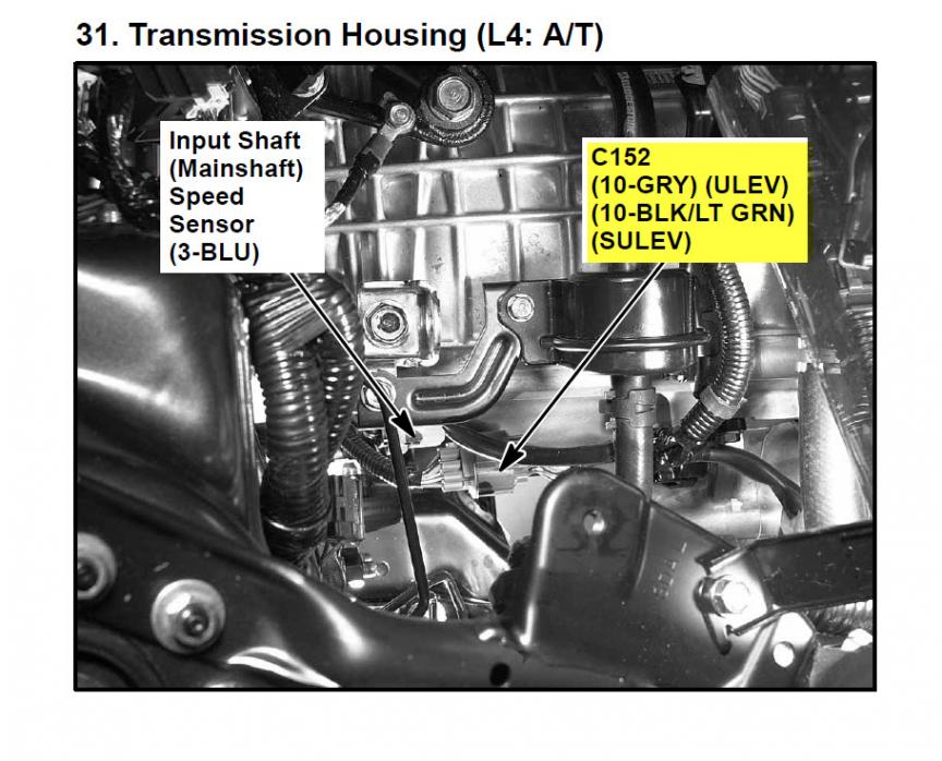

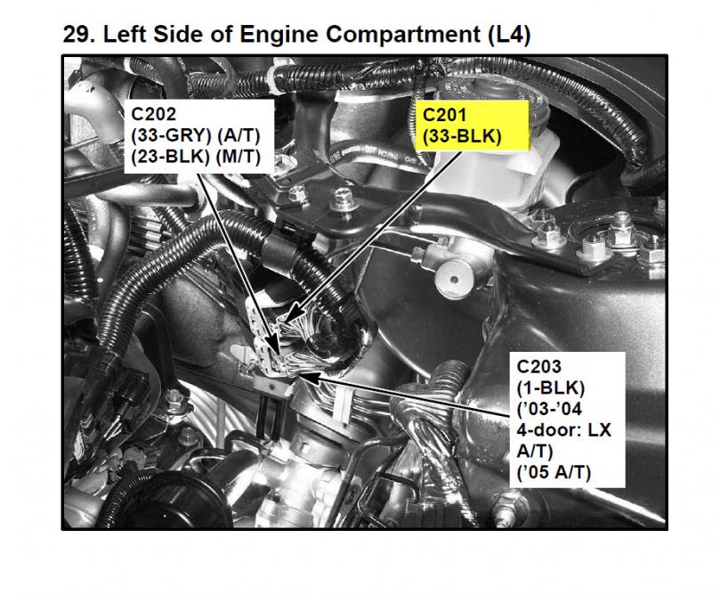

It most likely is a short in the circuit. That connector looks to be the junction connector C201 (a 33-P connector). The short may between that harness connector and connector C152. Check the Wht or Wht/Grn wire along that circuit.

Yes Jim, it is on that circuit for back up light (fuse #21), the Trans Switch wires up to it.
So there is some sort of a short somewhere.
I'm going to look at the pics and info in post 2 now.
edit:
So Connector "C 152" is the connector I've removed 2x and at the switch. That cluster of wires has continuity on each wire from C 152 end to the Trans Range Sw end.
(not sure if there can still be a problem. but they all have continuity, and looked fine. Connector pins all look normal / clean no black etc...). Trans Range Sw. is good. And, yes, it was C 201 I disconnected and then I can shift car trans in reverse without blowing the fuse, that's the only way I've found. So should I examine (how?) the wires from C 152 to C 201? And / or from C 201 on? Or, wait, I guess it can't be beyond that right... or can it, if the 12V gets returned from the Trans Range Sw back to indicate it's in reverse and activate back up lights, could it then be anywhere else upstream too? (?)
edit the edit:
Ok, RedBull, much thanks, after re-reading and studying all your attached pics, I think you're right, look between C 152 and C 201 for the short by looking at White/Green wire. Soo... should I pull apart the wire protector or try to run voltage up that wire - disconnected at both ends with a 12VDC test lamp in between that and the positive on my small extra 12VDC battery and the negative terminal? Is that a way to do this?
