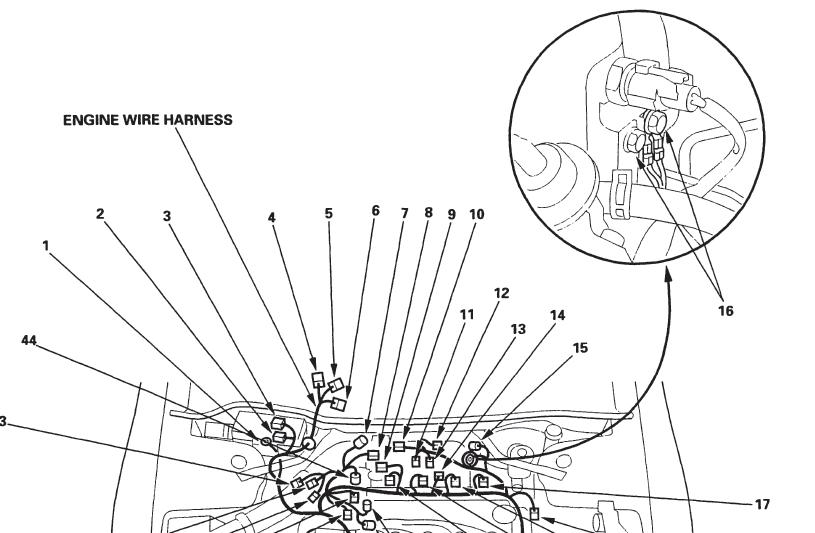

STILL, there is an intermittent problem that I do not know how to diagnose. Essentially, (I believe) the main relay (which is new) is getting turned on and off rapidly sometimes. I drove the car for about 5 miles just fine and then it started dying and coming back on quickly.
The tach would drop and then come back up. At first it happened just a bit, more like a hiccup but then, presumably as some component got warmer, I had to push the pedal down quite a bit and rev it high just to make it idle. I made a video of it that I can post on youtube if I would help.
I clearly heard the main relay making noise when this occurred. Rapid clicking almost like buzzing because something seems to be turning it on and off fast and then right back to normal.
I let the car sit and was able to drive it just fine. I do not know for sure that it is temperature related because some of the time fully warm, it ran fine.
This must be related to the erratic tach and spark which sometimes was fine.
I know it is no guarantee that it is good, but the distributor is only several months old.
What could be responsible for making the main relay turn on/off quickly like that? Arcing ignition switch?????
Old Feb 15, 2012 | 05:01 PM
Posts: 16,335
I would disconnect the battery and clean all ends of both battery cables. Also look around the engine bay for grounds that could be loose or corroded.
The main relay clicking could be due to loss of power from the ignition switch or possibly the ECU not grounding it properly. Without throwing parts at it, you may be able to back-probe the 12V going to the main relay and see if you are getting a voltage drop when the car starts acting up.

I did do the battery cables already actually.
In searching for loose grounds I have not come up with any.
Disassembled the ignition switch and cleaned. There was old caked grease on the terminals but the rest seemed fine. Car has been idling for an hour now with no problem whatsoever...
Are there any specific grounds that are notorious by any chance?

G101 grounds a lot of components. I think that is on the firewall on the the driver's side of the car close to the windshield.

Here's a link to the video. Just seems too evenly timed for a ground but I cannot rule it out.

The ground for the ECU is #16 in the pic.....on the end of the TB.
Attached Thumbnails Spark, injector pulse, fuel pressure, correct timing and no start...?-6th-gen-g101-loc-4cyl.jpg
