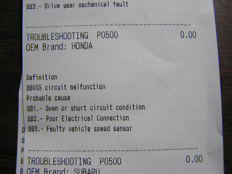

I stopped by another AutoZone and they checked the CEL error code. They only received one error code and that was the same as before P0500. The AZ person allowed me to see the screen on the test equipment. He even provided a printout that reads:
Definition
BBVSS circuit malfunction
Probable cause
BB1.-Open or short circuit condition
BB2.-Poor electrical connection
BB3.-Faulty vehicle speed sensor
You are correct the dealer does charge $50.00 for testing for the CEL error though the fee is waived if you do the work.
