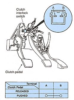

1. The attached is a picture of the location of the starter cut relay, which is below the dash. You should be able to see the Blk/Wht wire that is part of the connector.
2. This shows how to check the Clutch Interlock Switch.
Product & HowTo Info | | | TEST | AutoZone.com
To check a clutch interlock switch:
  • Disconnect the connector to the switch at the clutch pedal assembly.
  • With an ohmmeter, check for continuity between the terminals of the switch with the clutch released and with it engaged.
  • With the clutch released, there should be no continuity between the terminals.
  • With the clutch engaged, there should be good continuity between the terminals.
A switch can be checked by placing an ohmmeter across the switch's terminals and moving the switch through its different positions. Courtesy of Honda Motor Company.
  • If the switch doesn't complete the circuit when the clutch is engaged, check the adjustment of the switch. (Some switches are not adjustable.)
  • If the adjustment is correct, replace the switch.
  • Another way to check the clutch switch is to simply bypass it with a jumper wire.
  • If the engine starts when the switch is jumped, a bad switch is indicated.

Alright I got mah cah started up and running. But the problem was not what I was expecting it to be...
The problem was with the Clutch Interlock Switch (B), but not the switch itself. Apparently in my car (97' Honda Accord EX 2.2L M/T) and on the clutch pedal are two little plastic circular pieces: one for each clutch switch (A & B). These pieces are responsible for pressing against the tips of the Clutch Switches; although, they are connected to the pedal itself!
At some time the piece on my pedal must have been pushed out by the Clutch Interlock Switch and, without it pressing on the switch, the starting circuit was left open and the car would not start.
I am merely posting this update because someone having a similar problem with a 5th generation Accord can keep an eye out for this possible cause.
