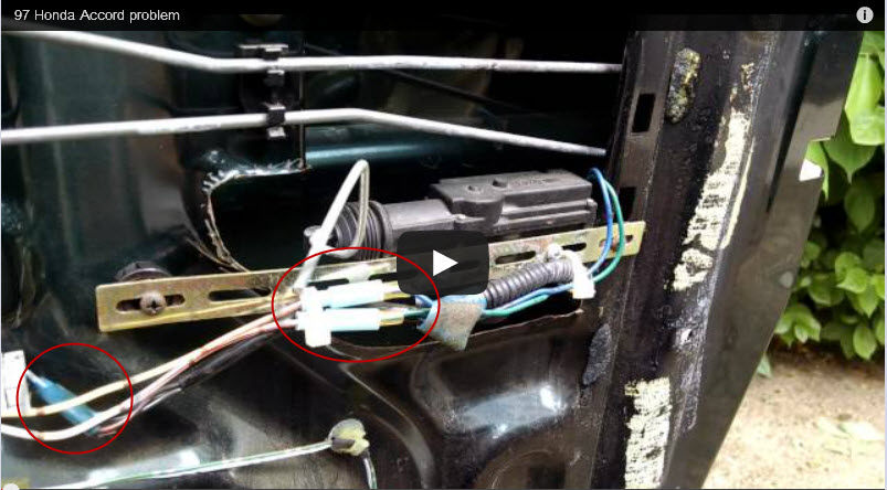

I've been having this problem where when I use power locks, my passenger door lock can't lock itself initially. It retries over and over again, flicking the lock from the locked, to a "half-locked" state. It will eventually lock, but this can take anywhere from 10 seconds to 2 minutes. Usually it is on the 1 minute side.
I removed the door paneling to investigate. I shot this video of the actuator and you can see the problem happen right away in the video (although the subsequent attempts worked fine).

That is an aftermarket actuator set-up with spliced wiring that may or may not be wired properly. Can be the actuator or wiring.

How can you tell the wiring is spliced? I wish I had a better camera angle. It didn't look like there was any splicing. The other wires in the picture I would assume are the window actuator, and they look fishy. I did have that part replaced a few years ago. Are you sure you aren't getting that confused since they are so close to each other?

That is a universal door lock actuator, not the OEM door lock actuator that came with the car. Splice may not be the exact correct terminology; but, it looks like aftermarket electrical connectors were used to connect the universal actuator wires to the car's wires.
On the OEM passenger door lock actuator the wire colors were Yel/Red and Wht/Red. On the passenger door switch, the wire colors were Orn, Blk/Wht, and Blk.

This thread shows a picture of how the stock door lock actuator on a coupe looks attached to the latch (removed from the car).
https://www.hondaaccordforum.com/for...cycling-48713/
On your car, part of the door sheet metal was cut away and the universal door lock actuator installed with a metal bracket.
