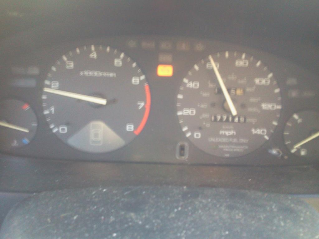

so on my to work this morning
As you can see here i was doing 60 mph at 1750 rpms, so had i been able to increase my speed to 65 i would have been running 2k rpms, on my way home tonight as i neared my house (on the same stretch of road) i found myself running 55 mph at 2250 rpms. Ridiculous! something is definitely going on here and im missing something thats causing it. I just cleaned iacv about 2 or 3 days ago but im noticing that sometimes when stopped in neutral no clutch i idle at "750" rpms and sometimes (seems like when warm) idling at 1k?
Is my iacv acting up? does this have anything to do with this other issue?
