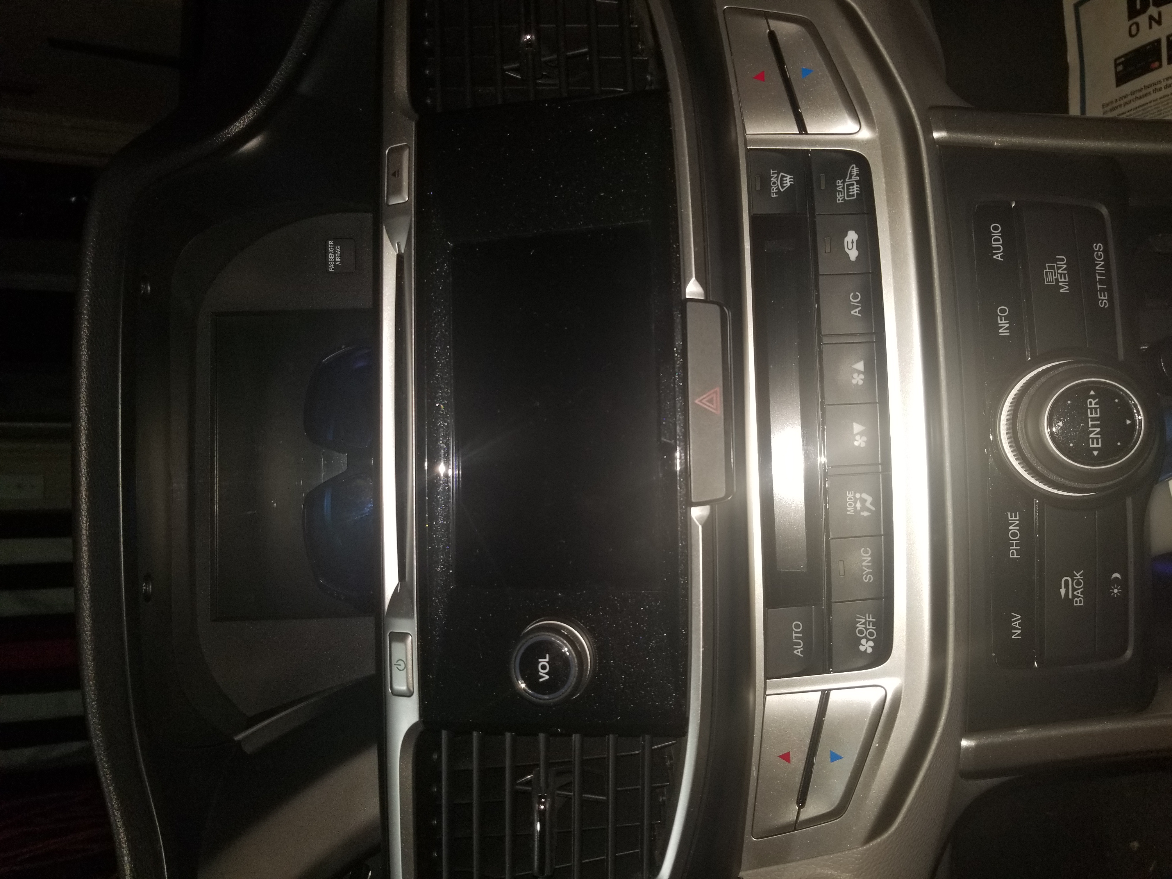

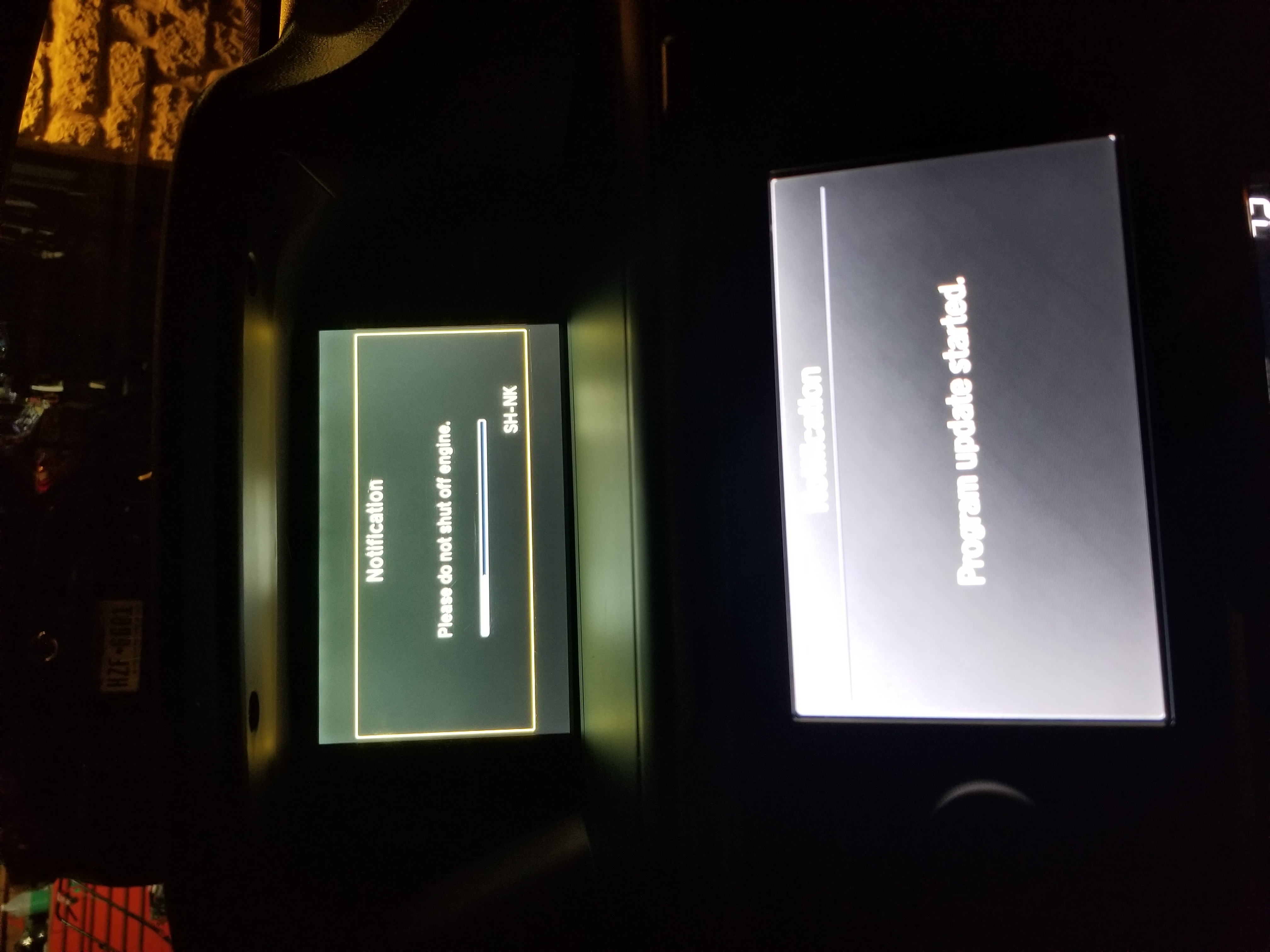

I made the grave mistake of pushing "Update" in the System Developer menu, and its been stuck there since. The upper screen shows a loading bar and "Please do not shut off engine" and the lower screen shows "Program update started". When the loading bar completes, the screens shut off, then the Phone initialization screen, the screens then go black again, then the upper screen shows the Home Link home screen, after that both screens go back to showing its updating. I've searched for days on different forums, and Google trying to find a fix but I cant.
  • I've had both Audio fuses pulled for 72 hrs straight - the only fuses I can find that seem related to the system, and the only way to kill the screens.
  • I've disconnected the battery for 18 hours straight
  • I just attempted a hard reset, I disconnected the battery terminals then attached a jumper from Pos to Neg, and left it for 90 minutes.
  • I have tried to re-enter the Diagnostic/Developer mode but it's not playing ball.
Each time I reconnect everything, the screens go back to the Update status.
I've had a friend reach out to his contacts at a dealer, they had never seen this before.
I also took it by a different dealer today, a few techs looked at it with no avail and said it would need to be sent into the shop... but I don't know if that would fix it at this rate.
I've seen a couple threads with this issue, all but one did not offer a solution. The only one that showed a solution said they pushed the CD Eject button to abort, but that didn't work for me.

Sorry, I should add that to my original post, I have tried a few times to re-enter the diag mode with no luck.
For my car is Menu+Back+Nav
