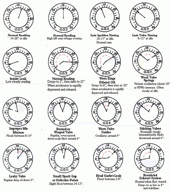

Back in the good old days this was good to have on hand.

So far here's what I did today. I pulled the PCV valve and it was toast! It was just like you described from your '89 LXi. I could see completely thru it. The spring was still inside but no other parts. No way for it to work as a check valve. I bought a new one from Carquest and installed it. After I installed the new PCV I noticed the sucking from the valve cover stopped completely. I'll be real happy to see if this make a big difference in my oil consumption. Next I pulled all the plugs and did a compression test. Dry and wet. Dry results Cyls.#1-180 #2-170 #3-150 #4-180 Wet with oil sprayed in each cylinder. #1-190 #2-210 #3-210 #4-200. Definitely some rings leaking. But still this isn't horrible compression. I have not done the vacuum tests. Where is the best place to hook up the vacuum gauge? I have one of them too, but must admit don't use it much. I'll look up that website TexasHonda suggested. Hondadude that picture looks like it could be worth a thousand words. It looks as if it will really help a guy to narrow down his troubleshooting. I'll post more next week when I fill up again to see how much oil is lost on the next 300 miles. Thanks so far for all the replies.

My friend hondadude is the "teacher" on these 3rd gen's (86-89). I've done my share but those things I've never had to do, my understanding came from him.

Now I'm gonna address the vacuum testing with HONDADUDE's chart he sent. I seem to have a bad miss in the engine. At times I think it's the auto tranny and at times I think it might be the axles (both CVs are clicking when turning). But it feels like a bad miss in the engine. The faster I go down the highway the less you feel it. It's real prominent at about 40-45 mph then smoothes out at 65 mph. Testing will tell. How do I mark this thread as fixed so anyone glancing at the forum will know it's fixed? Thanks again.
