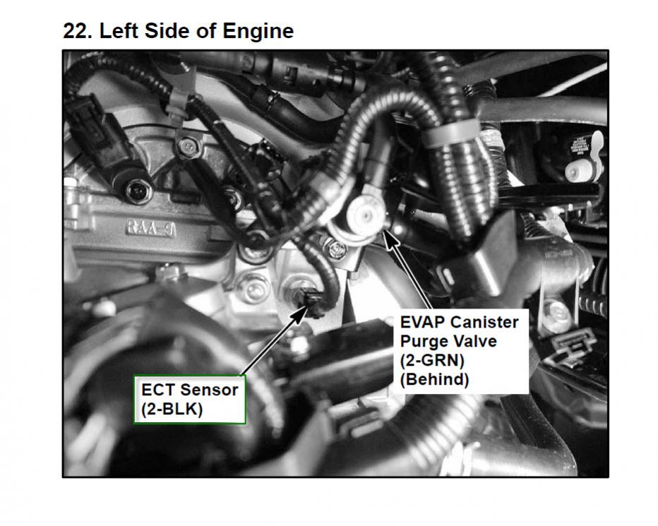

3. For your 2003 Honda Element, the cooling system is not really more or less complicated; just different.
For the cooling fans, the Element has only one fan switch unlike the 91 Accord with two switches. The first attached picture shows the location of the fan switch, which is at the bottom of the radiator.
On the Element, the coolant temperature gauge is controlled by the CPU built-in to the gauge assembly. The CPU receives coolant temperature information from the ECM/PCM. The ECM/PCM receives coolant temperature information from the ECT sensor. The second attached picture shows the location of the ECT sensor.
Attached Thumbnails Which switch?-2003-element-fan-switch.jpg   Which switch?-2003-element-ect-sensor.jpg
