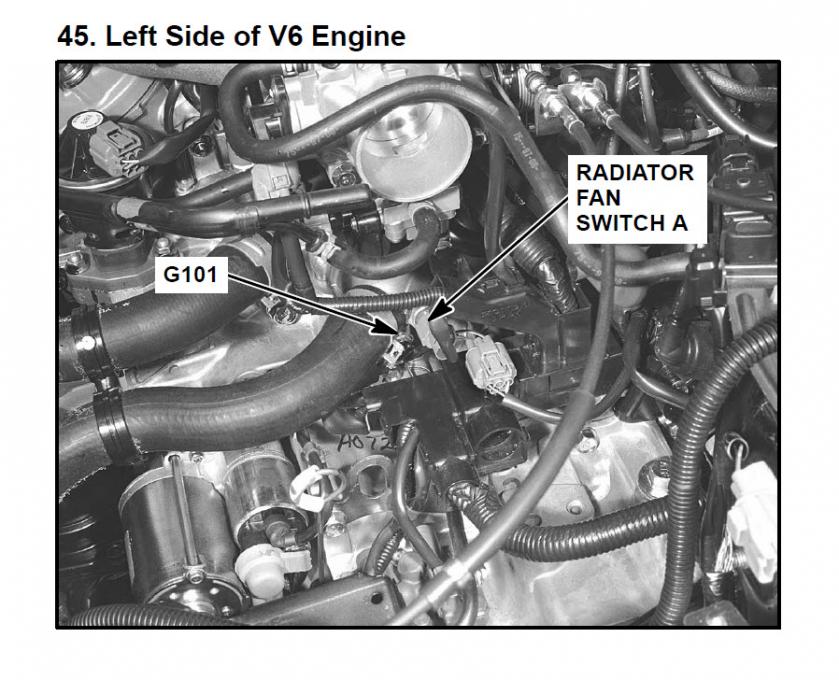

With the car on, when the coolant temperature is above 199 F at Radiator Fan Switch A, both radiator fan and A/C condenser fan should be running. Also, when the A/C is on, both fans should be running.
1. With the car running, turn the A/C on, does both fans run? They should run strongly.
2. Unplug the electrical connector at Radiator Fan Switch "A", and use a wire or small paper clip to jump the 2 pin harness connector. Turn the ignition to ON or Start, does both fans run strongly? See attached pic. for location of Switch A.
The V6 has a Radiator Fan Switch A and a Radiator Fan Switch B. Radiator Fan Switch "B" (located separately) runs the radiator fan after the car is turned off, if the coolant temperature at switch B is above 225 F.
