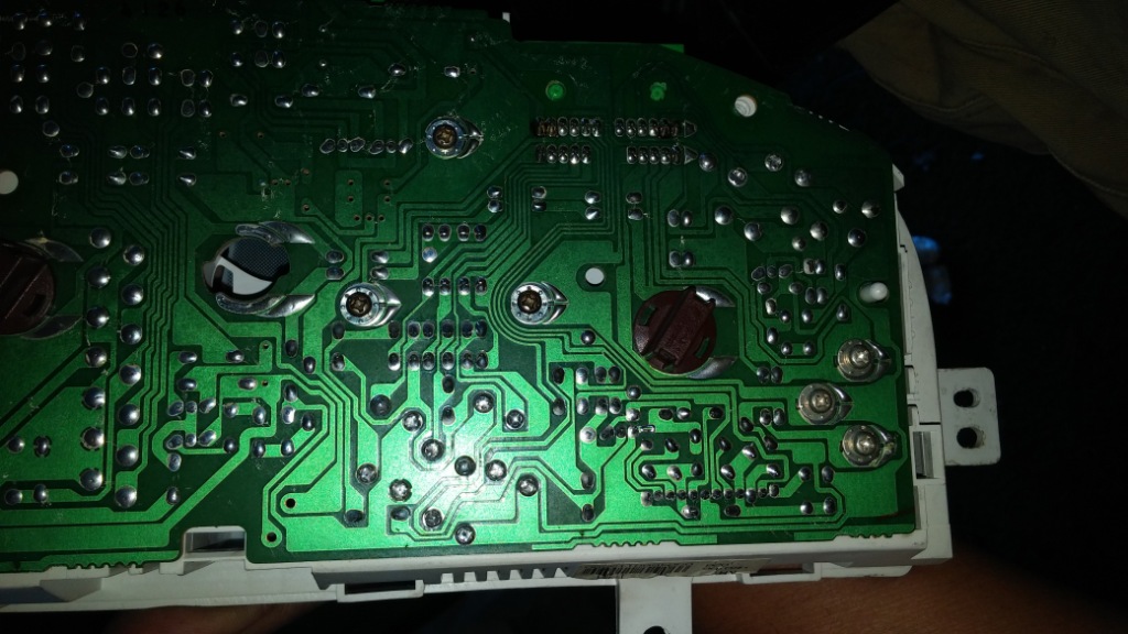

Here are some pics of the circuit board, think some of the solder joints need to be touched up?
Attached Thumbnails Temperature gauge is erratic-20170603_080645.jpg   Temperature gauge is erratic-20170603_080653.jpg   Temperature gauge is erratic-20170603_080705.jpg   Temperature gauge is erratic-20170603_080741.jpg

I have completed the following:
-Cleaned G201, G301, G2, and G101
-Replaced alternator (I have a spare)
-Unplugged temperature sensor and grounded with ignition on, gauge shot to hot.
-Resoldered all points on the instrument cluster that appeared to look suspect to me. All wires in the harness looked normal, no breaks.
Unsure on what next to check.
