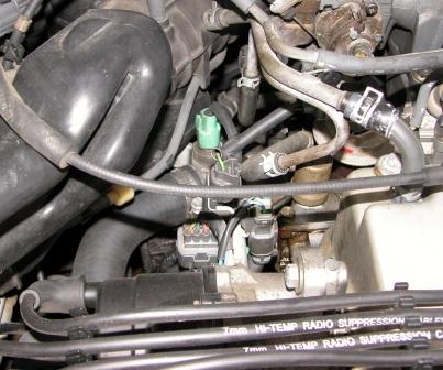

As a test. There is a two wire green connector on the t-stat housing. Pull the connector and jump the wires (not switch the connector with the wires) with a paperclip or something, turn the car to "on"/pos II and see if BOTH fans come on?
Not sure where you live but this time of the year (in north america) it could take 20~30 min of idle time before the engine gets warm enough for the fans (notice both) to cycle.
EDIT: See pic for location.....and yes the vtec was leaking on mine but I fixed it...in case anyone makes a comment.

After I read another thread and double checked to make sure I had no air in the system with the bleeding procedure, I found no air in system for sure. Took the car on a 20 minute drive around town, then parked it for about 7 minutes in the driveway, still no fans on. So, I jumped the connector at the T-stat and both fans came on. I plugged the connector back into the pins, wondering if it was possibly a loose connection but no difference. I am guessing now that I have to look at a new switch in the thermostat? BTW, I am in Colorado and it was warm here today, around 62 degrees! I did try out the A/C today and both fans came on for that action
Thanks again for your help, I really appreciate it. More ideas?
