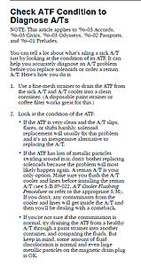

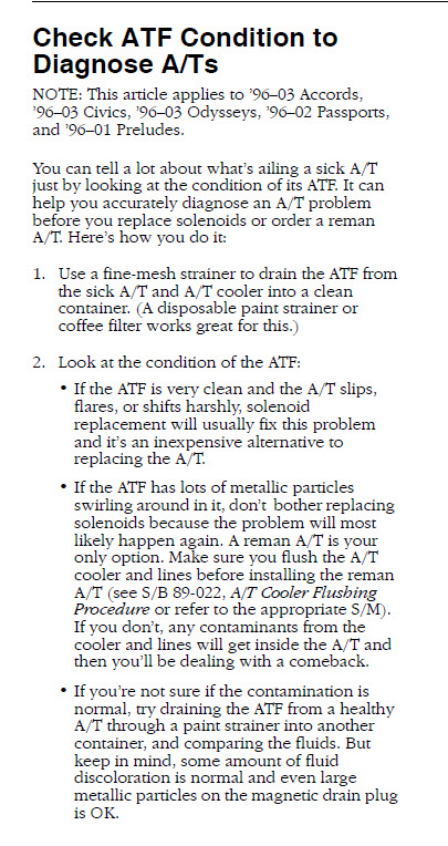

Metallic particles can circulate through the transmission even with the internal filter.
The drain plug is magnetic to try to catch some of this.
The attached image is from a 2003 Honda Service News article regarding checking the transmission fluid to try to help diagnosis a sick transmission.
