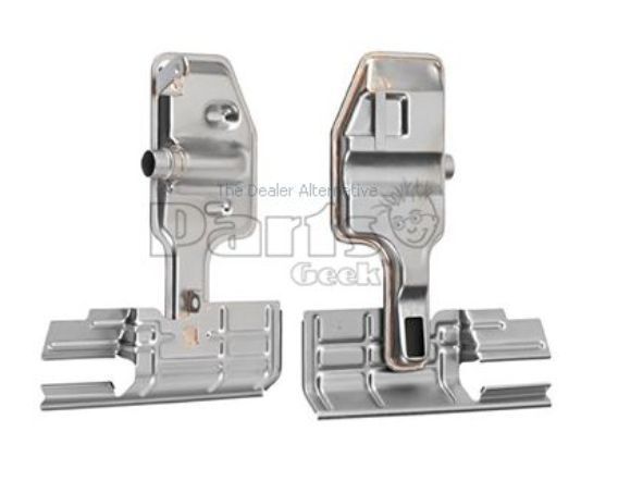

so I am looking at a rebuild. I am trying to track down a OEM transmission filter. I got he part number from Honda - 25420-P0Z-00. I believe it discontinued/backordered through Honda. but I am confused. I am seeing 2 parts,a filter and then a strainer. here are the 2 listings with the same part number. one doesnt have a picture. I have attached images of the filter and the other part which I dont know what it is (strainer?)
1 - https://www.ebay.com/itm/124662660506
2 - https://www.ebay.com/itm/166372447492
happy New Year!
bt
